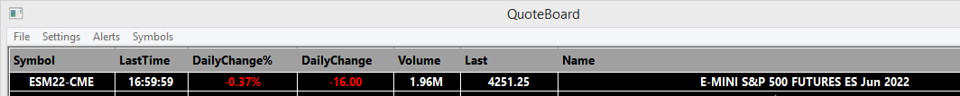

Today, 04/22/2022, at approximately 16:00 PM EST, I noticed on my ESM22-CME chart and Quote Board the Daily Change % and Daily Change fields reset to zero and continued their updating until the market close at 17:00 PM EST.
The final closing values on my ESM22-CME chart and Quote Board are as follows:
Daily Change %   -0.37%
Daily Change   -16.00
The final closing values from https://www.cmegroup.com/markets/equities/sp/e-mini-sandp500.contractSpecs.html for 04/22/2022 are as follows:
Daily Change %   -3.17%
Daily Change   -139.25

imageESM22 04-22-2022 Closing Values Sierra Chart.PNG / V - Attached On 2022-04-22 22:31:45 UTC - Size: 7.48 KB - 282 views
imageESM22 04-22-2022 Closing Values CME.PNG / V - Attached On 2022-04-22 22:31:59 UTC - Size: 19.62 KB - 350 views

There is nothing wrong here. Refer to the field descriptions here:
Getting Quotes: Field Descriptions
Refer to the description for Daily Change:

Thank you for your reply which helped me to better understand final settlement prices which I was not aware of.
What is strange is the Daily Change % and Daily Change fields reset to zero approximately 1 hour prior to the daily close.
So would I be correct in understanding the CME sent a preliminary settlement price 1 hour prior to the daily close? That would seem strange to me.

Yes they absolutely do:
The fact that you see what you do absolutely proves that. Sierra Chart does not set any settlements or generate them. These are transmitted through as they are received.
The are multiple prices that come through. Sometimes three or four at different times.
