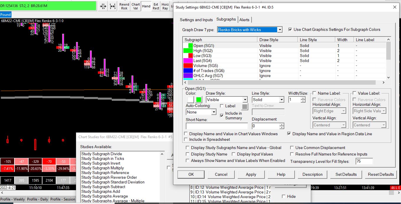

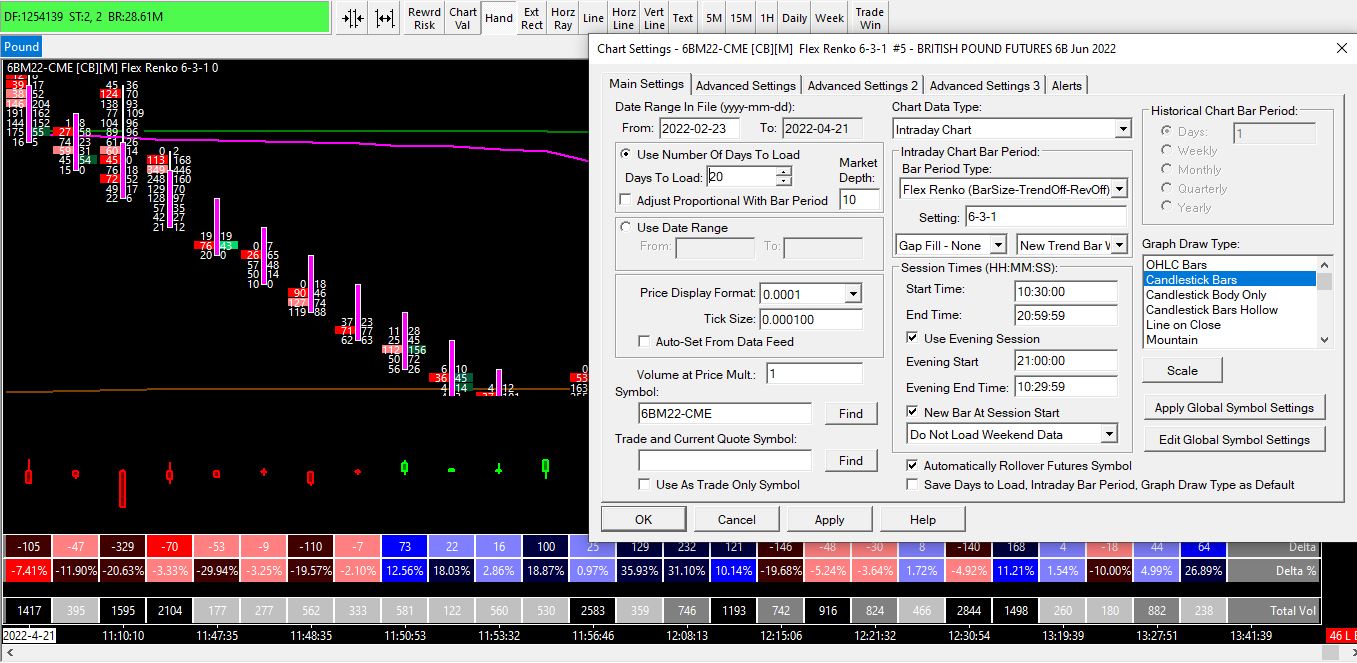

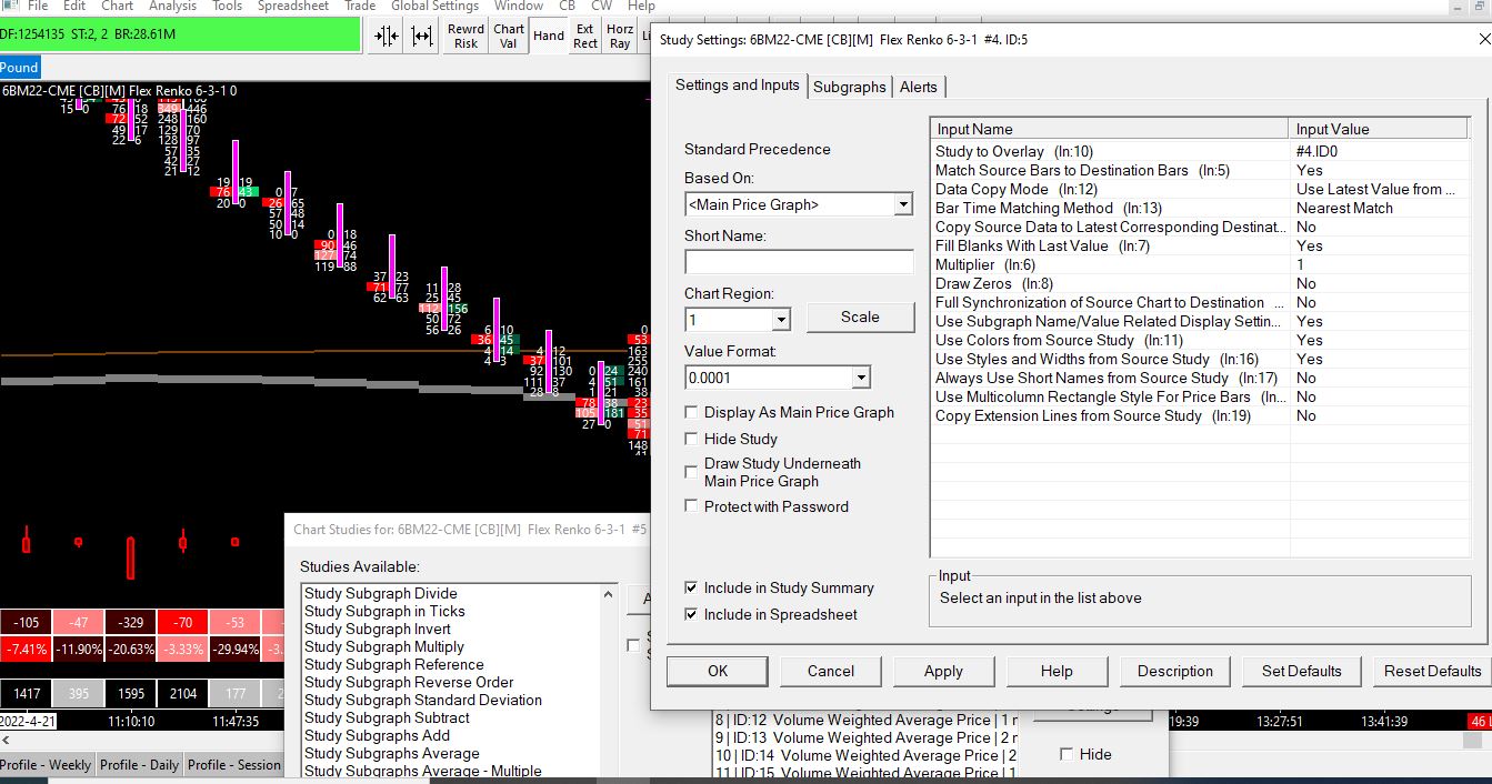

1 - Im using a number bar study on flex renko chart and would like to use the candle inside the number bars study.
For that im using the study called "Study Price/Overlay"... this study drew the candles but the candles were not correct..... what should I do? 3x picture attached

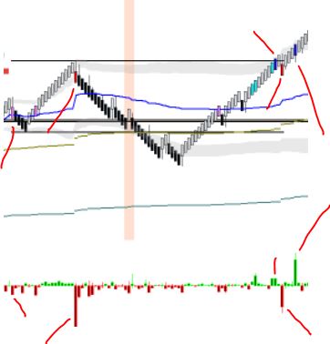

another question.. i would like to know how can I color the candles (make them red/blue inteasted of white/grey) if theres a high delta volume amount... like in the picture attached

With regards to the Numbers Bars, we do not know exactly what the difference is, but there is something different in the Chart Settings between the two charts that you are using. The easy solution is to not overlay a different chart. You can use the Study/Price Overlay and overlay the Main Price Chart for the same chart that has the Numbers Bars. You will then get the bars as you have them defined for that chart displayed in the Numbers Bars. We tried this and we got the bars matching up correctly.
As to coloring the bars based on a condition, you would need to use the Color Bar Based on Alert Condition study. Refer to the following:
