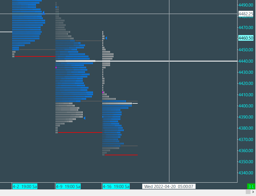

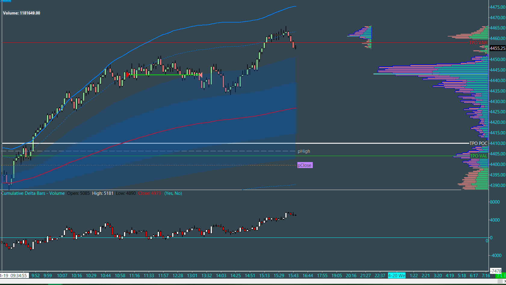

I have a TPO Value Area Lines study on my intraday chart and I set it up so that it displays the value areas and POC from my weekly TPO chart. The VAH and VAL lines are correct, but the PCO line seems to be way off, no where near where it is on my weekly chart.
Weekly POC for last week is at around 4440
On my intraday chart it is showing at 4409.75.
VAH and VAL are both in the correct spots.
Any thoughts?

Make sure you are using the TPO Value Area Lines and not the Volume Value Area Lines.
Next, make sure the weeks are starting at the same day between the TPO and TPO Value Area Lines. They should be by default, but we do not see any differences in the POC between these two studies, so it's one of the things to look at.
Otherwise, you would have to check the Chart Settings to ensure they are the same. If the one chart is not a duplicate of the other, then we recommend choosing one as a base and then duplicating it and putting on the appropriate study. This way the Chart Settings will be the same between the two.
