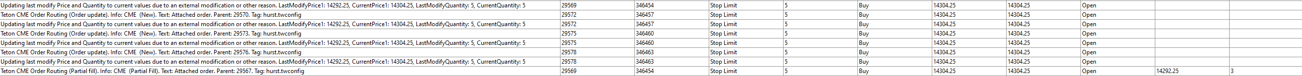

I have a question about the stop limit and fill price. I had a short open last night on /nq 4/13/22 22:39:12 PST with a stop price of 14304.25. /nq never reached 14304.25 and my fill price was from around 14292.24-14293.
Do you know why my fill price was so much lower then the actual stop?
In the attached screenshot red is what I listed as 'price' which aligns w/ my stop location and the blue is my fill price.
Private File

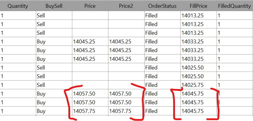

[2022-04-14 19:35:33]
User185631 - Posts: 12
I had the same thing happen on MNQ this afternoon. My chart was showing my stop 10 pts higher than where it was triggered/filled. Price didn't ever trade where my Stop was placed.
imageScreenshot 2022-04-14 143347.png / V - Attached On 2022-04-14 19:34:18 UTC - Size: 29.58 KB - 310 views

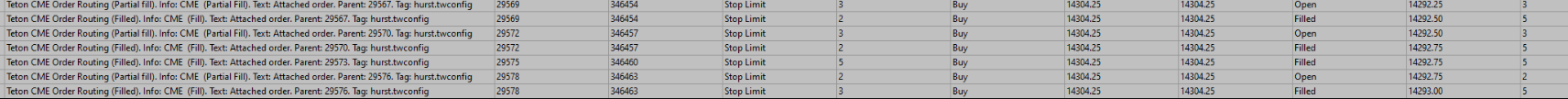

[2022-04-14 20:02:15]
User751739 - Posts: 29
The order action source is just my regular attached order brackets. This was quite an expensive issue for me, am I misunderstanding something here?
I don't have global profit/loss set, nor a position to close by a certain time. Also, 10pm PST is already considered the new day session, it wouldn't be considered overnight, but my account is setup to hold overnight.
Date Time Of Last Edit: 2022-04-14 21:03:48
imageScreenshot 2022-04-14 134114.png / V - Attached On 2022-04-14 20:42:04 UTC - Size: 107.3 KB - 216 views
