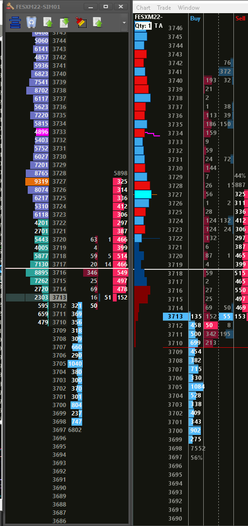

See the attached picture. There are bids and asks on the same prices.
It happened a couple times today. Sometimes overlap was 4+ prices. Sorry I'm using a different way to upload chart images than you suggest, but I didn't know about it when it was needed.
I am using SC 2382.

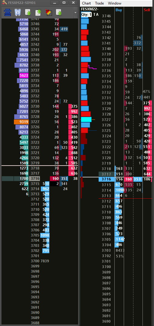

It's not the tick size. I changed it long ago, everything worked fine. The issue happened today. You can see in on the DOM that it's changed.
Attached another occurence, just happened as I was writing this replay.

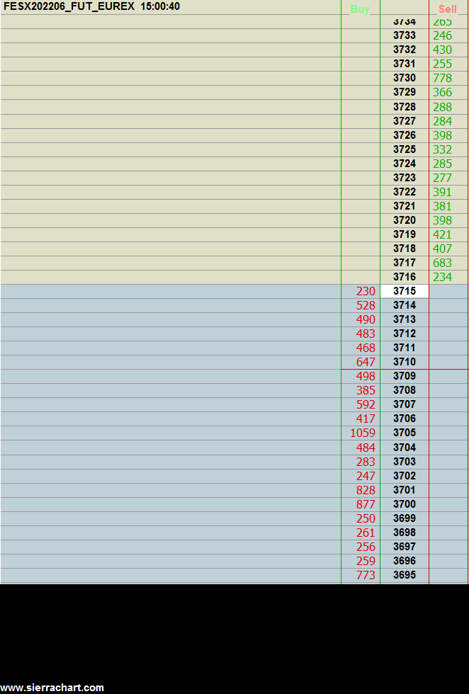

[2022-04-13 09:59:27]
Bango - Posts: 76
https://www.sierrachart.com/image.php?Image=1649843816523.png
same here

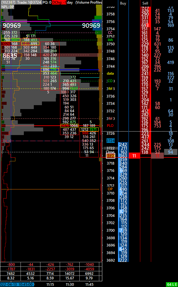

Can we get some info from Support about what this looked like on your end, and if there was anything on your end that was changed / done to correct it?:
As I said above - it seemed like initialy Sierra had the correct depth - but after the issue for other data feeds was fixed Denali was then having problems with incorrect depth levels.
*EDIT: Correction to my above - this behaviour is still occuring in Sierra
Date Time Of Last Edit: 2022-04-13 12:17:41
imageScreenshot 2022-04-13 131711.png / V - Attached On 2022-04-13 12:17:34 UTC - Size: 139.15 KB - 317 views

We are not observing any issue with the market depth for that symbol:
https://www.sierrachart.com/image.php?Image=1649854849509.png
We have reset the connections between the source data feed and our real-time server process. That fully refreshes the market depth data on the real-time server and causes the same on the Sierra Chart side.

User150671 - Posts: 80
Reference the attached - there are still discrepencies between Denali and CQG Market Depth AND the issues discussed above are still occuring.
imageScreenshot 2022-04-13 141121.png / V - Attached On 2022-04-13 13:11:57 UTC - Size: 127 KB - 252 views
[2022-04-13 13:19:50]
We cannot do anything about the discrepancies due to the nature of the EOBI data feed. That will have to wait until tomorrow until we have a fresh connection and a new order book. It is not possible for us to do anything now if things have gone wrong on the EUREX T7 side and faulty or incomplete data has been provided on the T7 feed, aassuming that even happened.
The market depth to us looks perfectly fine.

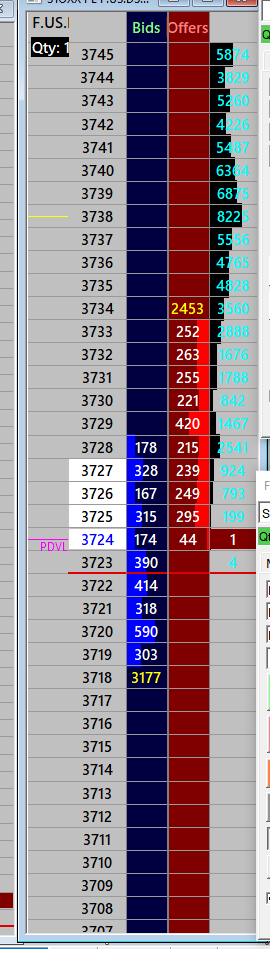

Look at the pictures provided.
Watch the video provided.
You can see where FESX has traded below a level - and yet still has market depth on the bid i.e. the Bid and Offer are overlapped.
You can see the difference in size on the Bid and Offer with CQG via Tradovate on Jigsaw (Left DOM) and Sierra with Denali (Right DOM).
The fact that I have to spell this out is absurd.
There was a problem across the board with EUREX - Denali - TT - CQG - every Data Provider had an issue; YET Denali was the only data feed still having problems over 6 hours later.
