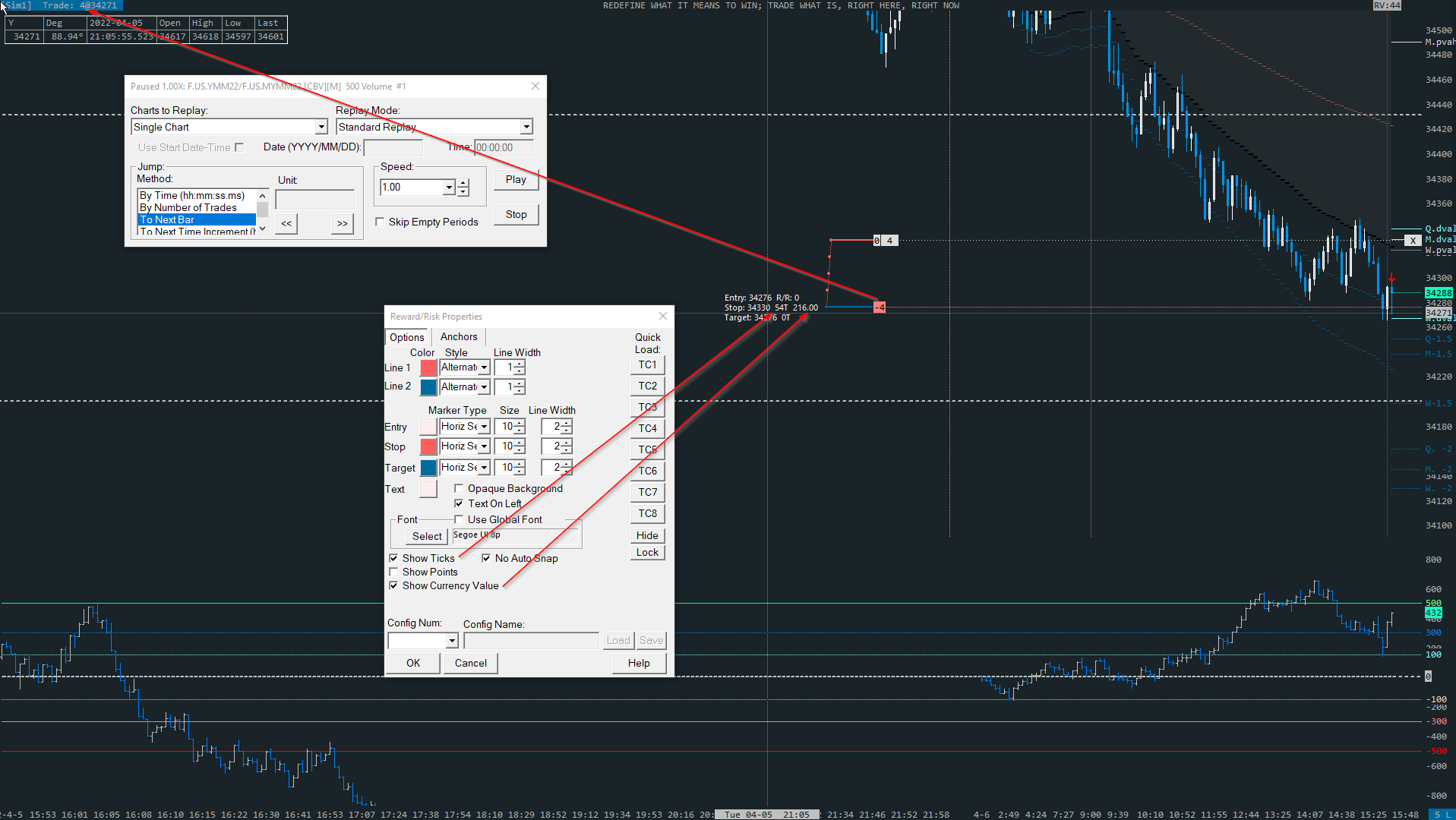

I noticed that my Rewards / Risk tool displays a wrong monetary value compared to the market I trade.
I'll give you an example; (as per picture)
I use the MYM, which has $.50 per tick
The stop is 54 ticks away, which, if traded with 4 contracts, should be a total stop of $108
However, the Reward / Risk tool shows 216, which signify $1 per tick, which is wrong.
I have the same problem also with other markets as well.
Can you please help me out?
Thanks,
Fabio
image12-04-22 17_52-.png / V - Attached On 2022-04-12 15:54:14 UTC - Size: 152.99 KB - 326 views
[2022-04-12 16:57:17]
John - SC Support - Posts: 48222
Please go to Chart >> Chart Settings >> Symbol and tell us what value is entered for the Currency Value per Tick.
[2022-04-13 06:55:30]
Fabio - Posts: 154
Oh I see.. Is set to 1 when it should have been set to 0.5, I guess?
But it never happened before, actually, I never touched that field (not to mention I didn't even noticed before)
So when this issue happens it's enough going into this setting and change it manually?
[2022-04-13 14:25:40]
We do not know why that would have changed, but yes, you can just manually change it and it should stay at what you set it to.
