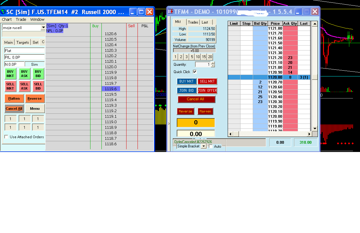

very satisfied with the platform, it looks like I'll have to change the broker, I'm interested in one of these broker's recommendation, with regard to responsibility and see that most of the DOM as a trade this right, I would have liked to have left the house because I'm used to long time, depending on what you get is always left home with any broker? thanks
Date Time Of Last Edit: 2014-04-29 18:14:01
imagetrade DOM.PNG / V - Attached On 2014-04-29 18:13:15 UTC - Size: 65.84 KB - 538 views
[2014-04-29 21:45:06]
This is the TransAct/Infinity trading Run the right side of the image that you posted. Please contact Patrick at Infinity at this email address and they will get you set up:
p.zielbauer@infinityfutures.com
We do not understand the question.
Date Time Of Last Edit: 2014-04-29 21:46:10
