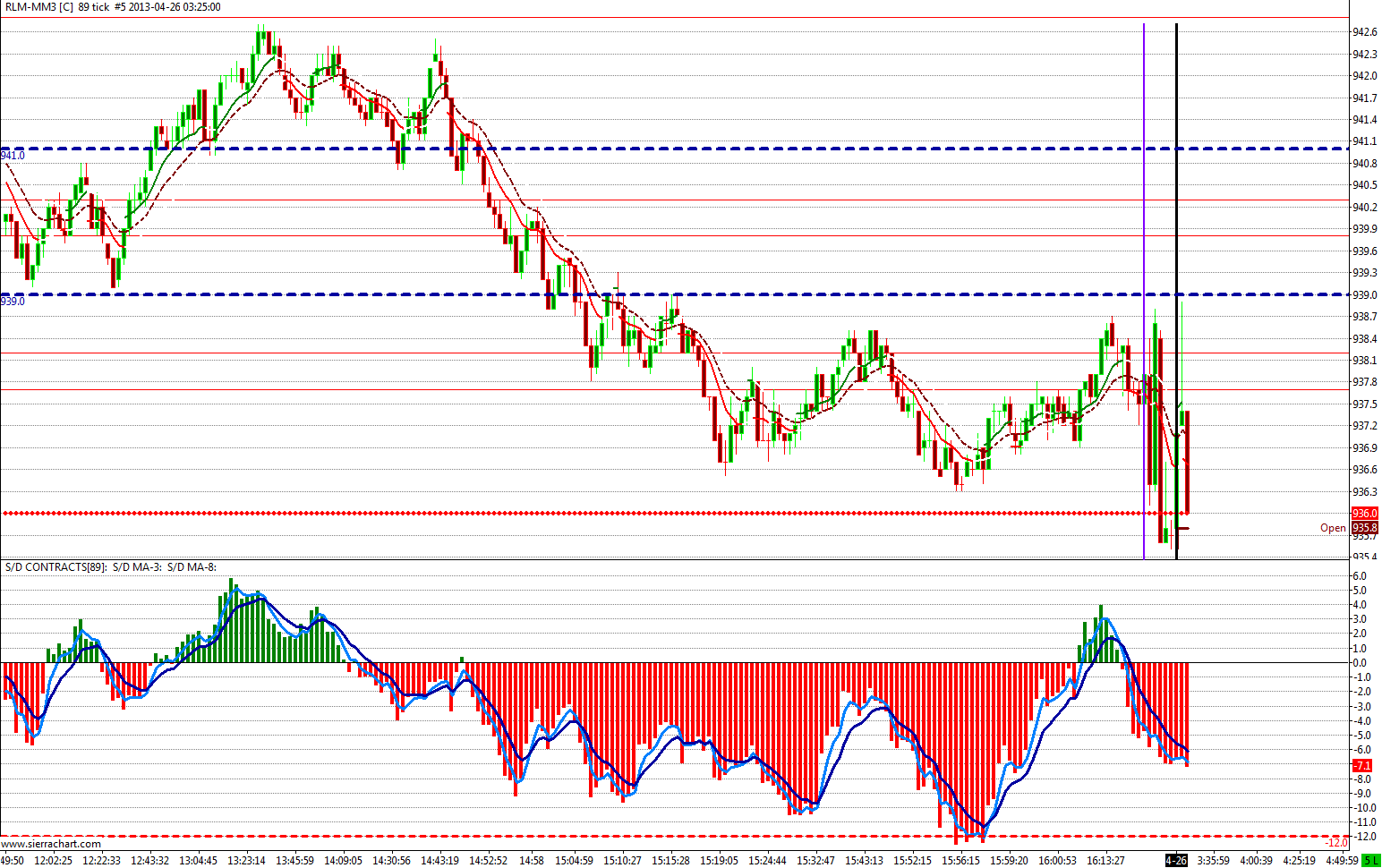

I'm using a rectangle drawing on the chart for red-color filld rectangles:
http://www.sierrachart.com/image.php?l=1366961054538.png

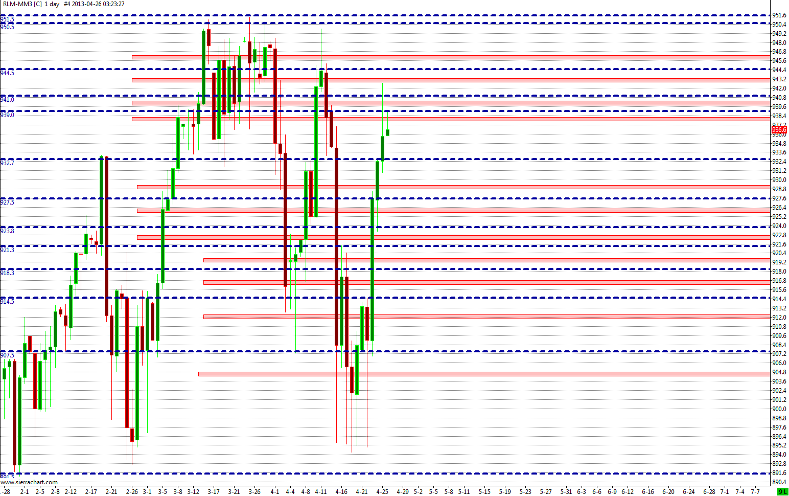

Then I'm importing these rectangle to another chart:
http://www.sierrachart.com/image.php?l=1366961129398.png
As you can see, the fill color (red) disappeared and rectangle is shown "empty".

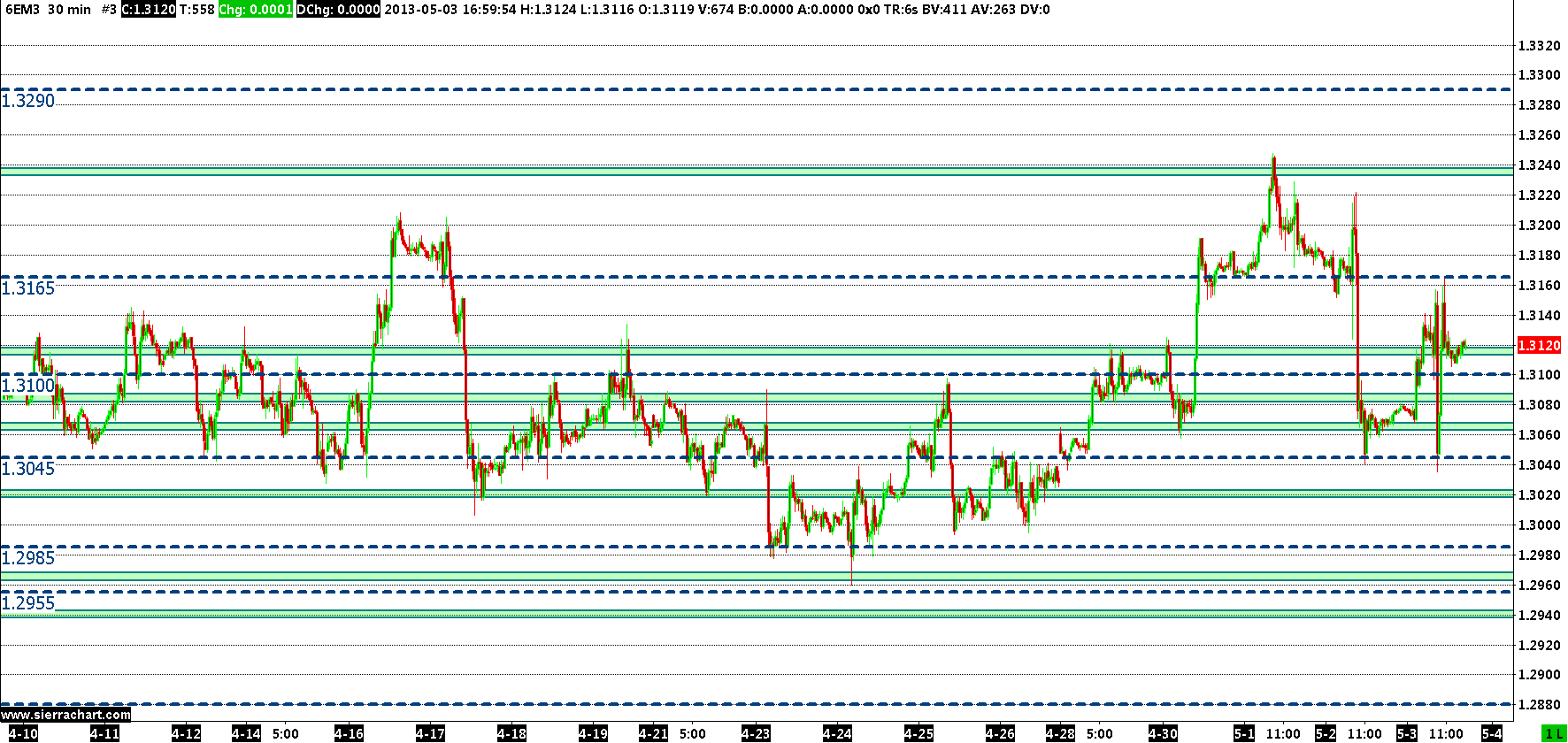

Please see attached chartbook with 2 charts: "Original rectangles" and "Imported rectangles". If you change the vertical scale of the "Imported rectangles" chart, then rectangles' fill color will appear, but I expect the color to be visible for any vertical scaling.

[2013-05-03 22:03:59]
It looks OK for us:
http://www.sierrachart.com/image.php?l=136761859331.png
