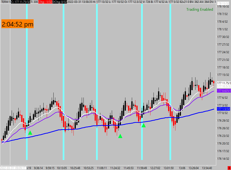

Thanks. still cant get a signal to appear but error is gone. There is no comparison between the two, i am just trying to get a signal when ID4 prints and then within 3 bars of ID4 printing ID 21 prints.
| [2022-03-31 19:07:05] |
| User312053 - Posts: 13 |
the light blue background is ID4 and the green up arrow is ID21, SO just when ID21 (green arrow) prints within 3 bars of ID24(light blue background) https://www.sierrachart.com/image.php?Image=1648753492337.png |

Using another instance of the Color Bar Based On Alert Condition study, try this: =OR(AND(ID4.SG1[-3], ID21.SG1), AND(ID4.SG1[-2], ID21.SG1), AND(ID4.SG1[-1], ID21.SG1)) |
| [2022-04-04 18:47:27] |
Tom, that is exactly what i was looking for, thank you !
