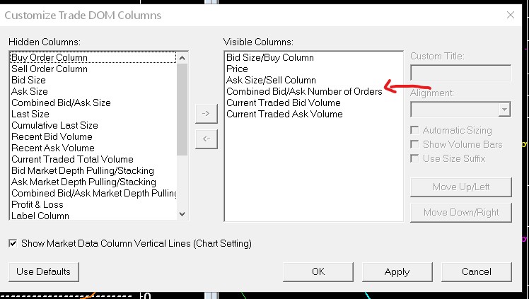

I would like to have the number of orders data in the spread sheet with the other market depth values (for example pull/stack). How do I get those in the spreadsheet ?
If code is needed, can you just reply with what ever is needed or add this feature please.
Attached is what I refer to as number of orders (combined or not)
Thank you
imageNumber of orders.jpg / V - Attached On 2022-03-28 19:05:05 UTC - Size: 77.4 KB - 289 views

You would have to program this using ACSIL. One of the functions you would need is the following for the Bid side (there is another for Ask):
ACSIL Interface Members - Functions: sc.GetBidMarketLimitOrdersForPrice()
[2022-03-28 21:09:18]
That is not the correct function for the number of orders at each level where there is market depth data. You need to use: sc.GetBidMarketDepthEntryAtLevel, sc.GetAskMarketDepthEntryAtLevel

I lack the knowhow of your reference. How do I come about entering this in the spreadsheet ?
In any free cell I enter =sc.GetBidMarketDepthEntryAtLevel ? that just returns #NAME? so I guess I need to have that function to reference to but I dont understand in all this.
Pls advise.

These are not spreadsheet functions, they are ACSIL functions for which you would need to create a custom study. Refer to the information starting here:
Advanced Custom Study Interface and Language (ACSIL): Introduction
If you want to look for a programmer to hire, we have a list here:
List of Third Party Sierra Chart Study and System Programmers
