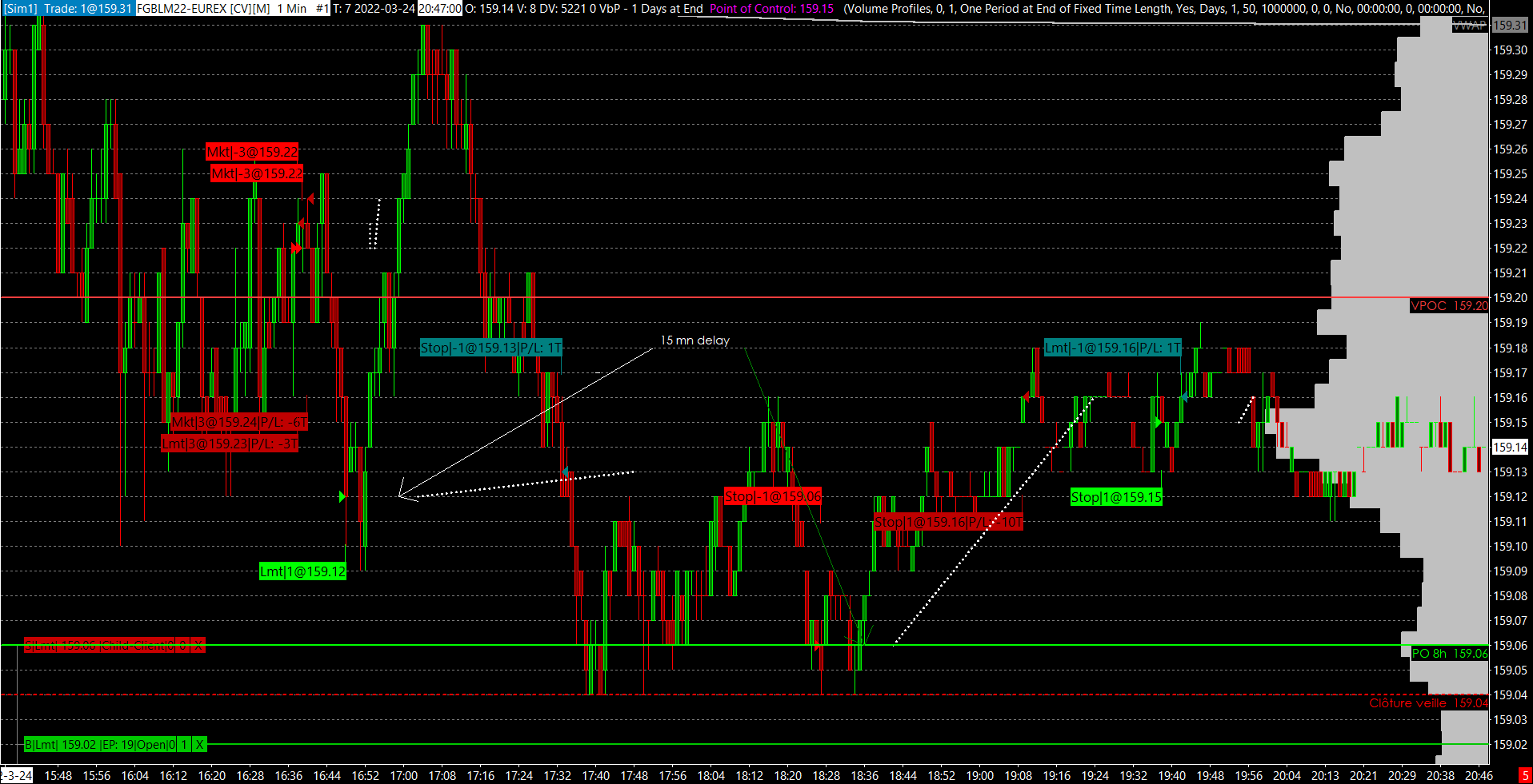

| User914407 - Posts: 65 |
Bonjour, Voici le chart : https://www.sierrachart.com/image.php?Image=16481925394.png Autres questions : 1/ j'ai un décalage de 45mn entre l'heure du chart et l'heure en haut de la fenêtre dans le bandeau "Sierra Chart 2357 ..." => ex : 07:22:00 dans le bandeau "Sierra Chart ..." et 08:07:00 dans le chart ? 2/ comment faire apparaître le VWAP sur le DOM ? Merci Date Time Of Last Edit: 2022-03-25 08:38:38

From Google Translate: Hello,
Here is the chart: Other questions : 1/ I have a 45mn difference between the chart time and the time at the top of the window in the "Sierra Chart 2357 ..." banner => ex: 07:22:00 in the "Sierra Chart banner ..." and 08:07:00 in the chart? 2/ how to make the VWAP appear on the DOM? Thank you It looks like your order fills are not matching up properly. Refer to the information here: Chart Trading and the Chart DOM: Accurate Entry/Exit State, Fill Matching and Position Quantities 1/ The first thing to understand is that the time displayed in the Title Bar (Sierra Chart Banner) is the time from your computer clock adjusted to the Global Time Zone that is set for your Sierra Chart software. The time in the chart header is the time of the last bar displayed in your chart - keep in mind that your chart may also have a different time zone than your Global Time Zone. The most likely reason for the difference is simply that the chart is scrolled back in time, such that the Chart Header is showing you the time of that last bar. 2/ If you are asking about the Trade DOM, then you would need to follow these instructions: Chart Trading and the Chart DOM: Adding Studies on a Trade DOM For the most reliable, advanced, and zero cost futures order routing, use the Teton service: Sierra Chart Teton Futures Order Routing |
I don't understand what and says in: Chart Trading and the Chart DOM: Accurate Entry/Exit State, Fill Matching and Position Quantities Isn't the 15mn delay due to the fact that I'm on a SIM? 1/ I changed "Time Zone" in the "CHART SETTING" but I can't get the same time as that of my pc. There is an hour difference (eg 4:00:00 p.m. on SC and 5:00:00 p.m. on my pc). Your data is delayed by 10-15 minutes depending on the exchange from which the data comes from. But this just means that you will only see the data coming in by that delay. Whatever actions you take on the chart at the time of the bar is going to be where the action is recorded. Therefore, if you place an order on the chart at 10:10 (chart time) and then close it at 10:25 (chart time), then that is where the fills will show. Therefore, you may not need to anything further if everything is matching up properly. 1/ The time zone for the chart must not match the time zone of your computer, or it may be a Daylight Saving difference. You will have to look at the settings and verify that the time zone settings are correct. Refer to the following for more information on time zones: Time Zone Setting For the most reliable, advanced, and zero cost futures order routing, use the Teton service: Sierra Chart Teton Futures Order Routing |
