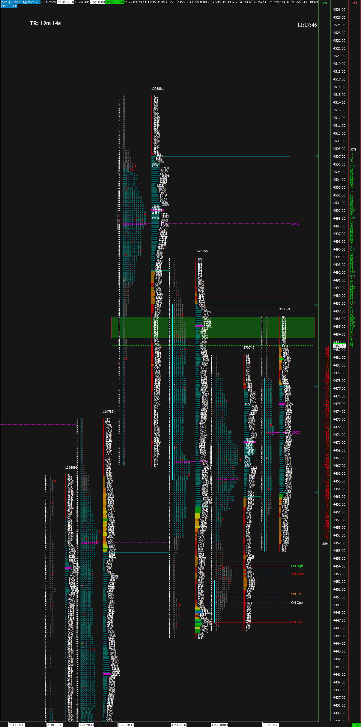

Hi. My daily TPO's are bunched up against each other. It's more of when there is lots of volume in the Volume By Profile for TPO Charts that the volume numbers are bunched up against the next days depth numbers. Here is a picture of the problem https://www.sierrachart.com/image.php?Image=1648135079871.png
Increasing bar spacing does not help, nor does moving the date axis.
Any ideas on how to add separation to each day? Thanks.

The only way to add separation is to increase the Bar Spacing. Therefore, you have us confused when you state that increasing the bar spacing is not working. Can you please increase the spacing and then take another image so we can see what is occurring.
Another option would be to change your Volume by Price profiles to have the Input for Right Align Volume Bars to Yes. This will reverse the position of the volumes, which may make them easier to read. Refer to the following:
Volume By Price Study: Right Align Volume Bars

I tried Bar Spacing once again and yes, you are correct. Increasing Bar Spacing does help separate them. I think I never followed through with this enough because what it also does is increase the separation between my TPO letters which is what I don't want.
I also tried setting Right Align Volume Bars to YES, but then without using the Bar Spacing my TPO letters are going under my volume numbers. It does help separate the days though.
I guess if I want to add separation between days without affecting anything else it is not possible at this time. Maybe that is an option the Sierra Chart could add? Thanks.

There is not a way to add separation between days without adjusting the entire chart using the Bar Spacing.
We do not know if we will ever be able to add spacing between the days as you ask, but we have set this as a Feature Request.
