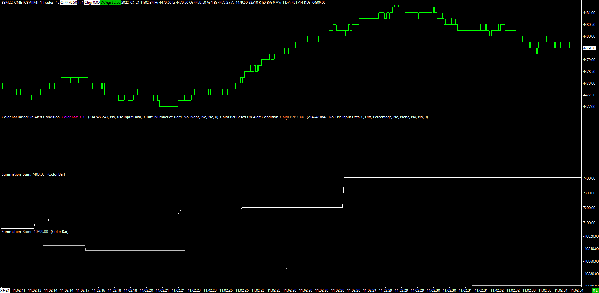

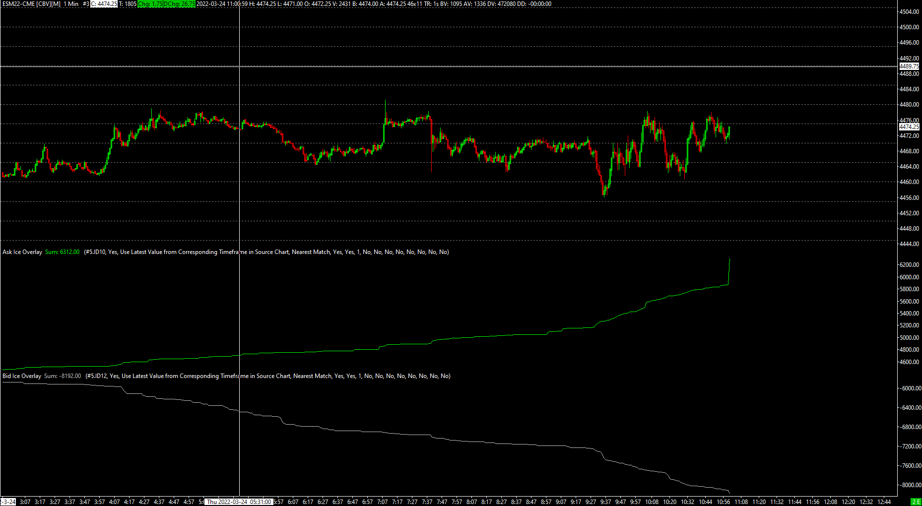

I am using 'color bar based on alert condition' to print specific values in a chart im using. using input data when condition is true and evaluating on bar close. then, i am using the summation study to sum these values. this works fine looking backwards and when i refresh the chart, but not when it runs live uninterrupted. the summation study is continuously adding values from the 'color bar based on alert condition' study, regardless of if the study ends up even printing anything. almost as if the summation is using the earliest values instead of the last values. I need it to sum the final printed values in real time, not just when i refresh the chart.
attached are two screenshots. because this summation is done on a tick chart, I overlaid it to a 1 minute chart so you can see more clearly what im referring to. the first image is before i refreshed the source chart to "reset" that summation, and the second is after i refreshed.

The issue is that the data is changing within the current bar, but it is getting added to the summation before it changes. In the end, this is due to the fact that you are looking at a 1 trade chart, but there is a minimum value for the Chart Update Interval, so the values are not exact for the current bar since the studies have not all been updated at every tick.
The solution is to look back by 1 bar so that the data for that previous bar has been properly updated when the Spreadsheet Formula is invoked for the current bar. To do this, you would need to change your formulas to look like the following:
=IF(ID6.SG1[-1]>0,ID6.SG1[-1],0)
Note that you do not need the "0+ID6.SG1", just having "ID6.SG1" is enough. The [-1] indicates to use the bar just before the last bar.
