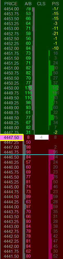

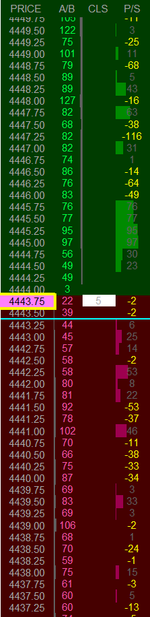

I am new to the Denali data feed, I have been using CQG for years. I use Pulling data for trade entry on an AutoTrade program. Visually these 2 data feeds as far as PULLING data are not even close to similar. One would assume that the same math is done the same in SC on both feeds unless both feeds are DIFFERENT. 1st picture is DENALI after a few minutes, The second one is CQG after a few minutes. https://www.sierrachart.com/image.php?Image=1647873704102.png https://www.sierrachart.com/image.php?Image=1647873960153.png

I do realize that these are not running at the same time BUT the Pulling numbers are negative and yellow. After a while all except for a few just disappear off of the DENALI feed, and the only ones shown are at the market Bid/Ask levels, so something is not the same.

Pulling and stacking calculations are difficult to do, and with the Denali Exchange Data Feed, it is much more precise. We explain this here:
CQG Trading Platform Service: CQG Market Depth Data
