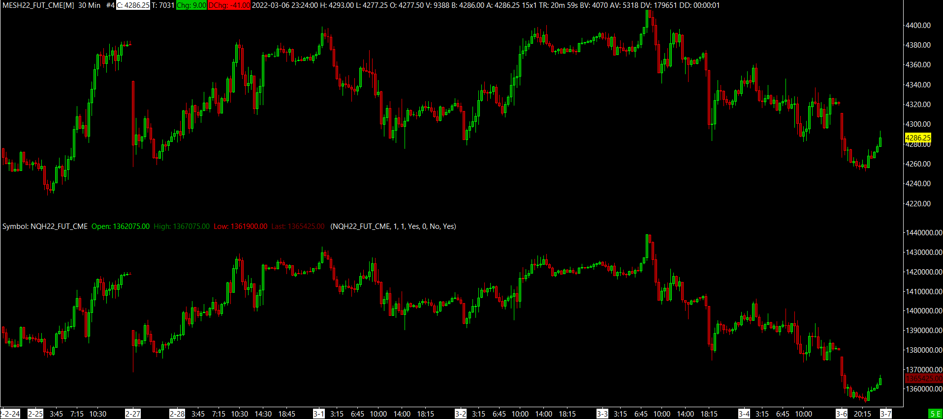

User841161 - Posts: 357
I have a chart of ES and am using Add Additional Symbol Study to have the NQ on chart region 2. The price being brought in by Additional Symbol Study is 1365425.00 and should be 13654.25. Couldn't find where to change settings to correct prices. When NQ is brought in on a separate chart the price is correct.
https://www.sierrachart.com/image.php?Image=164663064367.png

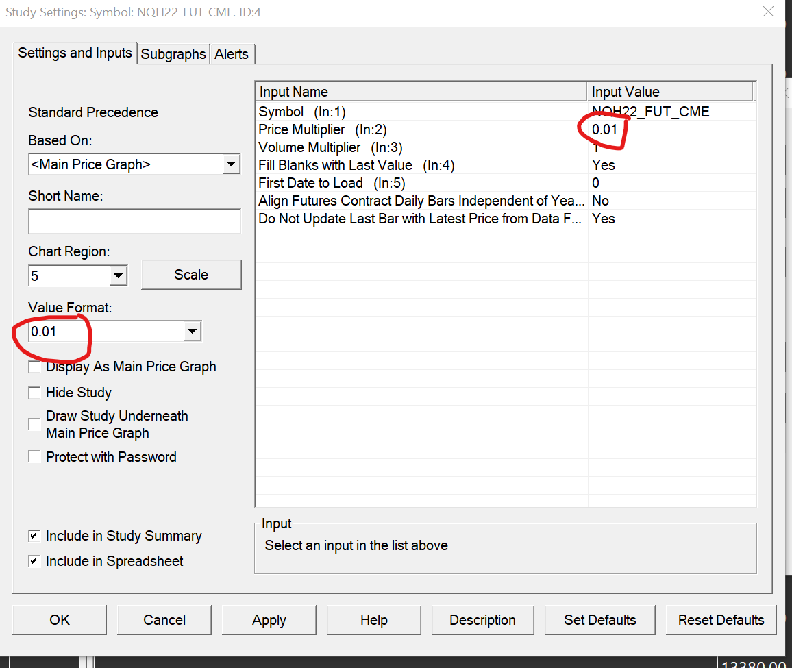

Tonkadad - Posts: 235
The only way I could get it to work, see pic
imageadditional symbol.png / V - Attached On 2022-03-07 19:28:40 UTC - Size: 88.07 KB - 527 views
[2022-03-07 20:06:37]
Thanks Tonkadad, that does work. Would think the default 1 price multiplier would be what it should be. In instructions- price multiplier says Defines to be applied to the additional symbol's price. By default, this value is 1.
For now can do that, maybe Sierra can fix the symbol price that is coming in?
Otherwise default price multiplier will always have to be changed.
[2022-03-09 01:42:22]
In this particular case you do need to use .01. We will give an example of that in the documentation:
