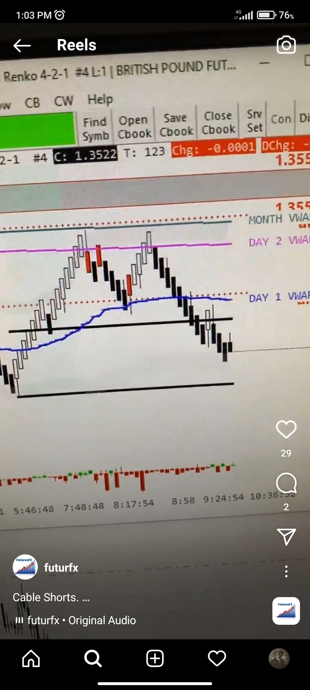

Dear Support Team
How can I extend my Previous Day Week Month VWAP Line on my chart I have attached an Screenshot For Better Understanding.
imageScreenshot_2022-03-02-13-03-49-097_com.instagram.android.jpg / V - Attached On 2022-03-04 20:54:13 UTC - Size: 757.23 KB - 534 views
[2022-03-04 21:15:47]
So for example you want the previous day volume weighted average price, displayed on the current day?

[2022-03-05 06:03:00]
FP - Posts: 5
@Sierra Chart Engineering
Yes exactly.
[2022-03-05 06:04:45]
FP - Posts: 5
@Tomgilb
Thank you but is that work on renko chart in their website they have mentioned only working on time base chart.
[2022-03-05 12:49:41]
FP - Posts: 5
I have find the solution, I used VWAP Rolling.
