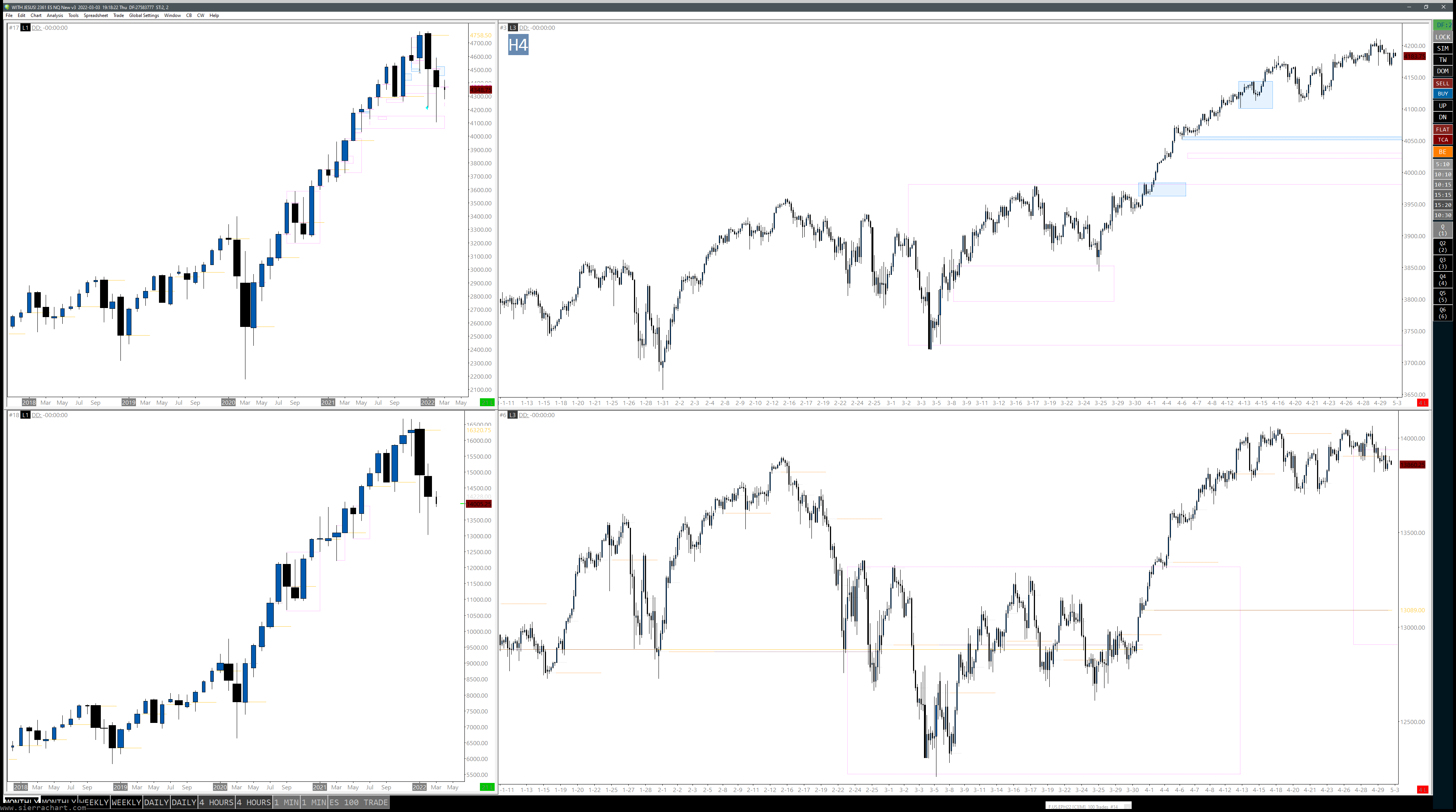

Hello SierraChart Team,
I am wondering if there is a way to make the wicks on the candlesticks slightly thicker, so that they are easier to see, especially for older or nearsighted people.
It would be ideal to set the thickness of the wick as a percentage of the thickness of the body, so that volume based candles have a respective width effect as well.
Thank you in advance for your consideration or any help on this matter.
Mike
https://www.sierrachart.com/image.php?Image=164635310564.png
[2022-03-04 15:10:43]
John - SC Support - Posts: 48169
You can change the width of the wicks using the following graphics setting and the one after it:
Graphics Settings: Bar High-Low Down
