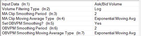

When I combine "Accumulation Distribution - Williams" and "On Balance Volume - Log" to this study, the result lines up perfectly with the OBV study. It does not result in an average. I get the same result using the "Study Subgraphs Average" study. This also happens occasionally with other studies. Please advise, thank you very much!
Date Time Of Last Edit: 2022-03-03 22:08:52
imageOBV-Log Settings.jpg / V - Attached On 2022-03-03 22:08:32 UTC - Size: 28.63 KB - 237 views
