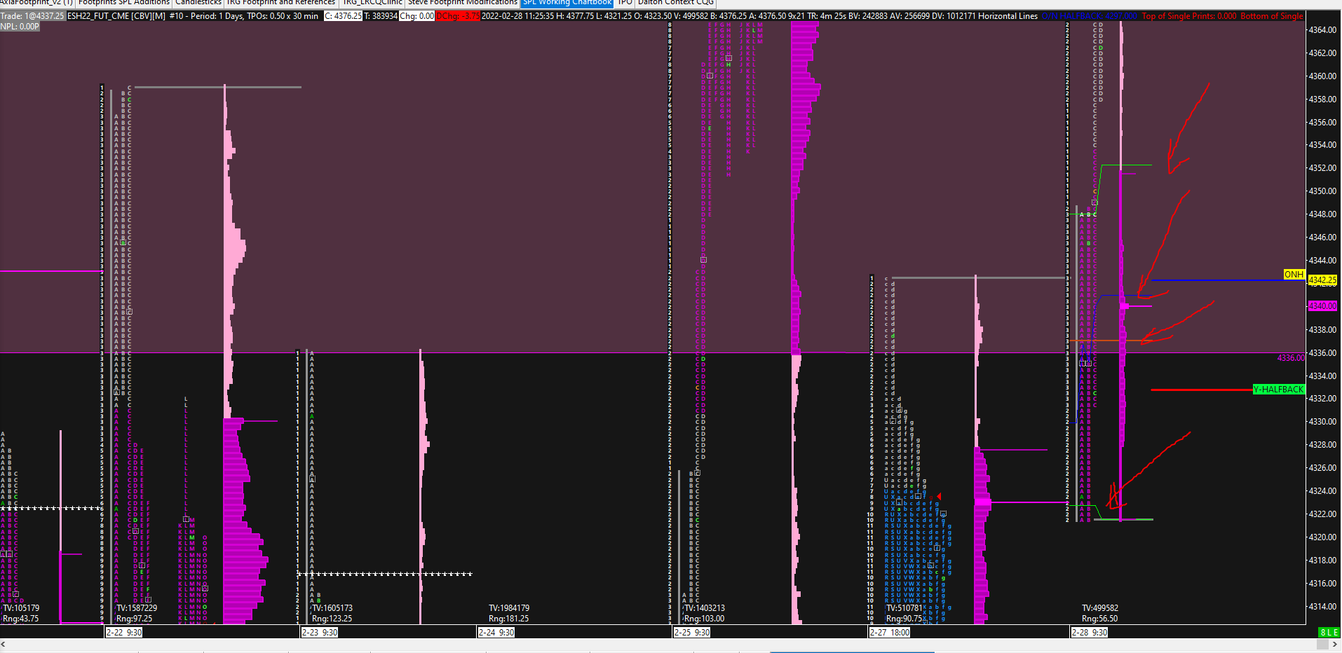

1) I duplicated a TPO chart to another chartbook and a series of lines are showing up that i cannot understand where they are coming from. Attached is a screenshot

1. Those lines look like "Developing POC/VAH/VAL" lines, although we do not know why they would be displaying as they are. Check your Volume by Price settings to see if the POC/VAH/VAL lines are set to be displayed and if they are, then turn them off and see if they go away.
Otherwise, you would need to look at your other studies and see where the lines are coming from. There has to be a study that is creating them, you would just need to find it.

1) The lines were from a study overlay that was changed significantly when the study was duplicated to a new chartbook. This has happened to me on other occasions as well with different charts/study overlays
