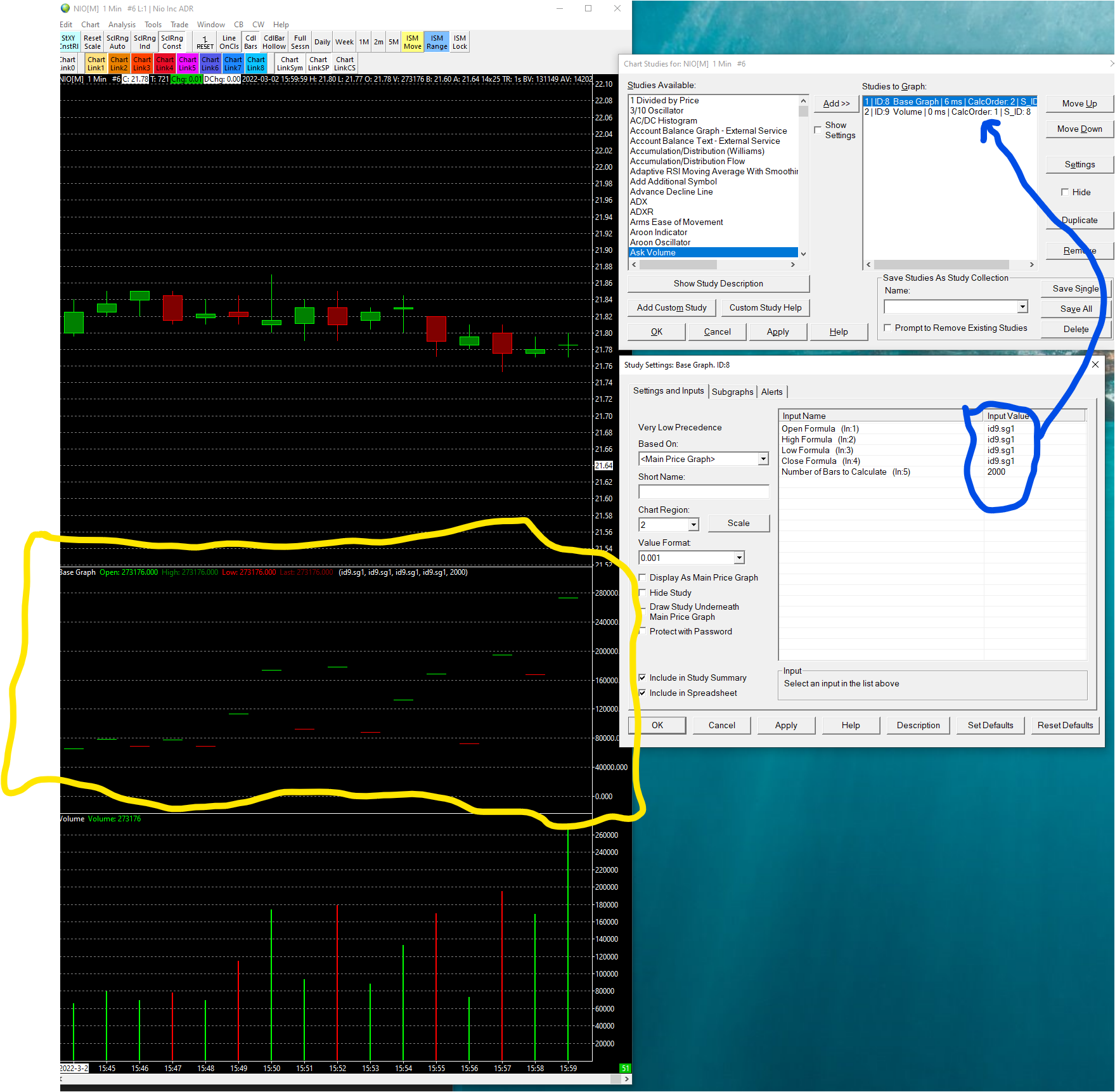

[2022-03-03 07:32:36]
User278398 - Posts: 296
i try with simple formula, but i dont get full data...
please check the pic i uploaded.
i got only "last",
second, it is not looking to a "bar"
what i need to do to see it correctly ?
regards.

[2022-03-03 15:10:38]
John - SC Support - Posts: 48303
You need to set each of the Open/High/Low/Close to a different formula. Having them all be the same formula will give you the line as you see as they are all the same value.

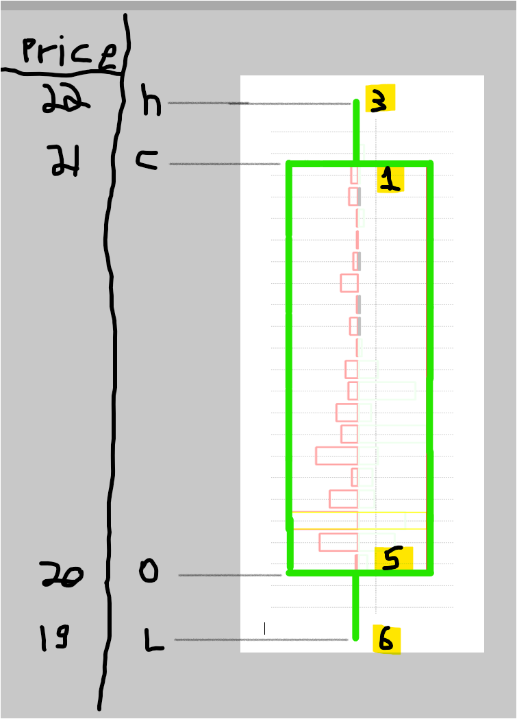

[2022-03-08 15:54:18]
thank u for your response.
i attached pic which describe what i want to display (according to the example above)...
which studies will do that ?
thank you.

[2022-03-08 17:21:19]
Sawtooth - Posts: 4357
Do you want to display the Volume OHLC values at the price bar's OHLC prices?
[2022-03-09 06:26:30]
yes
(i want to display the volume in this example... but in regularly i want to display the value of formula i built by spreadsheet formula study)
many thanks.
[2022-03-09 13:36:40]
There is no native study that will do what you want.
There is no DrawStyle that can place a value at a certain price.
You would need to create a custom ACSIL study.
