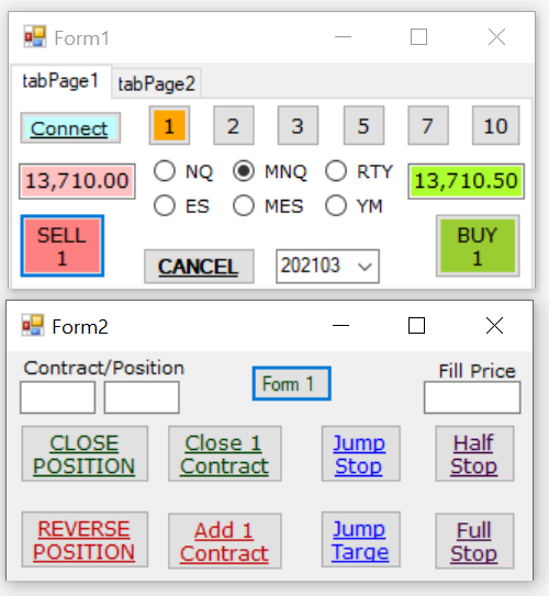

I also have created a program with IB and TWS/API (see attached pic)
but now that I switched to Denali and Teton I want to create a program that
can interface with that.
imageTrading app 1.PNG / V - Attached On 2022-02-26 02:43:28 UTC - Size: 80.34 KB - 409 views

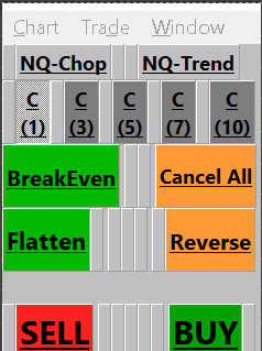

DOM trading toolbar.
I created a rough version of what I basically want with a trading DOM and toolbars (got most of the how too from a "Trade Your Plan" video, Thanks!)
missed the part about how I attach to a chart.
It doesn't send sim trades to chart? Not sure what I have to do?
imageDOM ToolBar 1.png / V - Attached On 2022-02-27 04:04:49 UTC - Size: 10.73 KB - 422 views
[2022-02-27 06:40:27]
Tonkadad - Posts: 235
Figured it out:
Needed to have on "Trade Window"/"Trading Keyboard Shortcuts Enabled" checked.
[2022-02-27 18:36:31]
