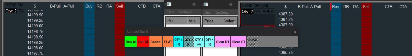

Is there a way to add the attached order drop down window to a control bar?
I attached a snip of what I am referring to.

[2022-02-25 17:02:28]
This is not supported, but you can create Control Bar buttons for specific configurations. Refer to the following:
Control Bar: Control Bar Trade Window Configuration Buttons

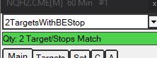

ok just to clarify.... if I add a control bar to my main SC chart window and float it like the one is this screen shot, which trade window will it inherit its bracket order from ? I am assuming its whatever chart/ chart dom I have actively selected ?

[2022-02-27 15:46:47]
Yes this should be correct, but we would have to test this.
It most likely has a dependency upon whether there are any attached charts to the main window of Sierra Chart. If there are, then it would be whatever chart is active in the main Sierra Chart window.
