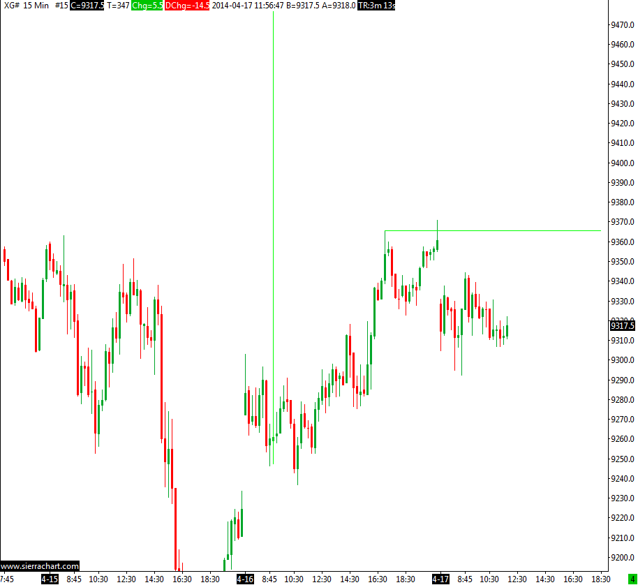

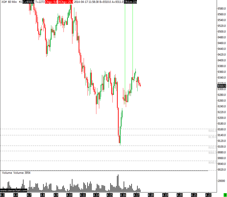

[2014-04-17 11:04:31]
User41512 - Posts: 58
http://www.sierrachart.com/image.php?l=13977322081.png
http://www.sierrachart.com/image.php?l=1397732320970.png
Further to your request, please see the 2 attached charts. The source chart is the one ending in image number 2081. As you can see there are 2 rays, one going vertically and one going horizontally. The 2nd chart is the destination chart. On this chart both of the rays are going vertically? I have simplified the charts but on my working chart there are significant numbers of rays which are going vertically, when they should be horizontal. Thks.
[2014-04-17 16:35:29]
The problem is the two points for the Ray drawing are too close together and span only a single bar on the 60 minute chart.
The easiest solution is to delete that drawing and to use the Horizontal Ray tool instead.
