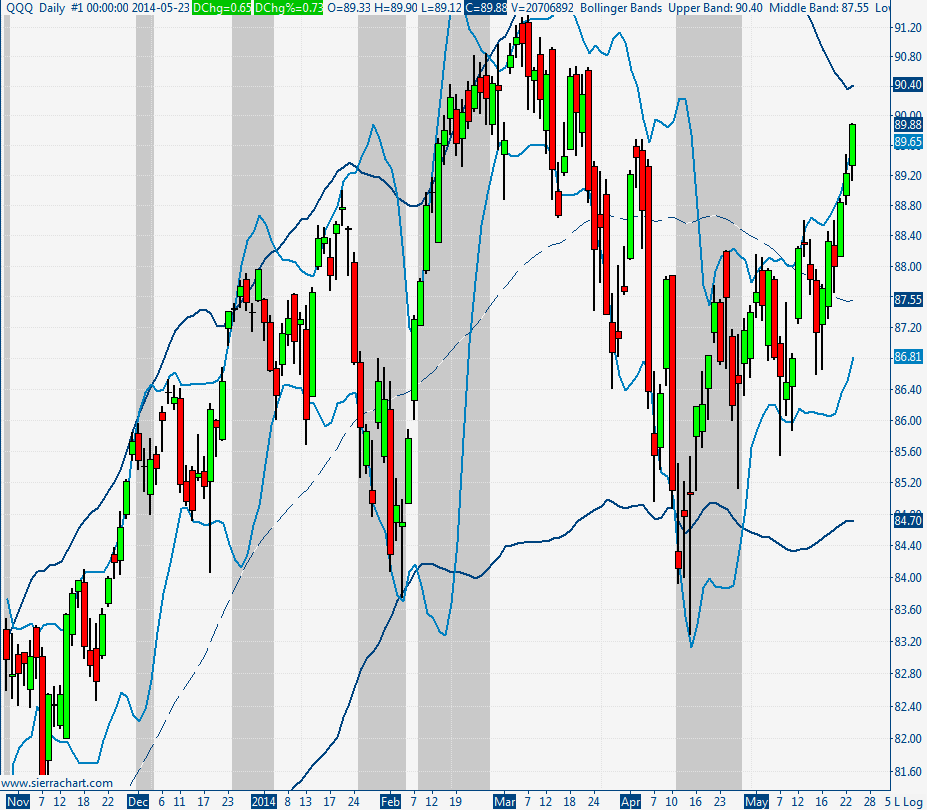

[2014-05-24 16:18:08]
RQ - Posts: 50
M5amhan, I am hoping you can help me out with code for an alarm.
I use two Bollinger bands; the length setting (bars back) is different. For purposes of this discussion let's say the small Bollinger band length is 10 and the large Bollinger band length is 50.
I am not interested in the middle band; I focus on the upper and lower bands.
Alarm condition if the upper band on the small Bollinger crosses above the upper band on the large Bollinger I need an alert and I would like (if possible) to be able to change the background colour of the chart; and the background should stay coloured until the small upper Bollinger band returns back inside the large Bollinger upper band.
I want exactly the same thing but just in reverse for the lower Bollinger bands. (Chart background colour should be the same for the Bollinger higher or lower breakout.
Is this possible? Thanks
[2014-05-25 02:15:21]
M5amhan - Posts: 468
=OR(ID1.SG1<ID2.SG1,ID1.SG3>ID2.SG3)
use the study called color background based on alert condition
that is assuming the 50 period is ID1 and the 10 period is ID2
imageQQQ Daily #1 41784.088.png / V - Attached On 2014-05-25 02:08:31 UTC - Size: 102.48 KB - 554 views

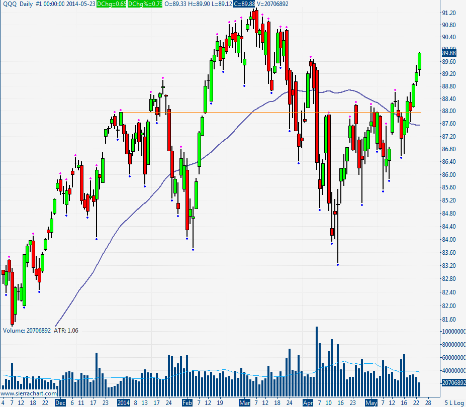

attachmentpivot point alert.pdf - Attached On 2014-05-25 17:05:50 UTC - Size: 121.67 KB - 1213 views
[2014-05-25 19:42:36]
use two of the "color bar based on alert condition" and check "evaluate on bar close" on both of them
pivot high: =AND(H>H[-1],H>H[1])
pivot low: =AND(L<L[-1],L<L[1])
set draw style to "point on high" for pivot high & "point on low" for pivot low
imageQQQ Daily #1 41784.821.png / V - Attached On 2014-05-25 19:42:33 UTC - Size: 63.06 KB - 594 views
[2014-09-04 14:49:50]
OneMoreTick - Posts: 79
I used this to create pivot dots for pivot highs/lows and they're great but they're not updating in real time. The dots don't print in real time. I have to open the study settings page and select "Apply" to get them to show up. I've been experimenting with the Alert page settings (enabled, reset condition on new bar, alert only once per bar, evaluate on bar close) but I haven't been able to figure it out to get them to show up in real time. What selections are required to keep them showing up in real time?
