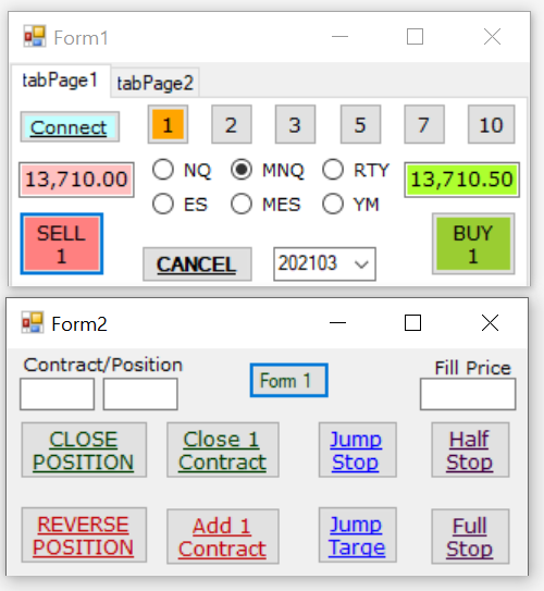

Does anybody have any code to get the ball rolling to create an app to replace the "Trade Window".
I created one for IB, but moved to Teton and want the flexibility to create what works for me.
imageTrading app 1.PNG / V - Attached On 2022-02-11 22:54:39 UTC - Size: 80.34 KB - 526 views

I'm interested in developing an app/form to replace the Trade window as shown above also. Is anyone working on it?
