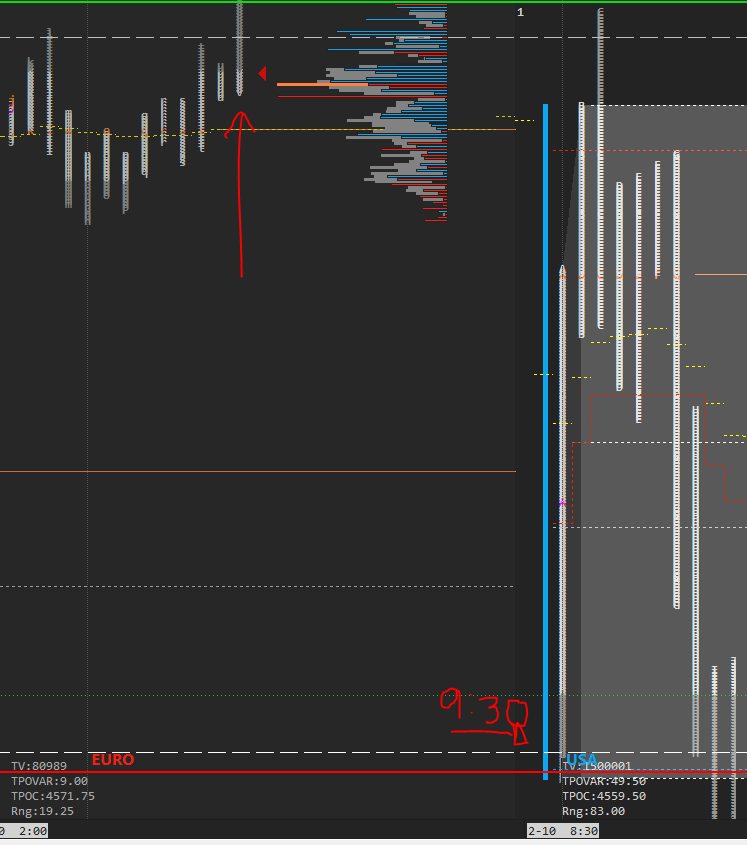

I have a chart that is divided in US/ASIA/EURO session. However the last hour on the TPO charts

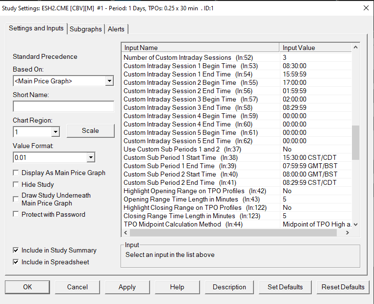

I have included the time settings.
What am i doing wrong? ive tried many different time combo settings and nothing has worked. Im on EST

Specifically what time range is missing and we need to get that particular chart:
Date Time Of Last Edit: 2022-02-11 00:09:50
[2022-02-11 01:01:32]
User449884 - Posts: 237
Here it is, i removed the studies that i know wouldnt interfere with the issue.
What is missing is the last 2 TPO periods of the Euro session. So from 830am-930am Est, i see the price line moving but not TPO printing
attachmentChartbook4.Cht - Attached On 2022-02-11 01:01:28 UTC - Size: 12.25 KB - 372 views
[2022-02-18 23:00:09]
Sorry for the delay in getting back to you on this.
The issue is just in your times. First, your Session Times do not line up with the Sub-Period times that you selected, in particular your Day Start Time was set to 09:30, but your End Evening Session was 08:29:59, so you were losing an hour there. The second issue is that you had the break in the day at the wrong time - you had it from 16:00 - 17:00, but that is the Central Time break, whereas your chart is set for New York, so the break is from 17:00 - 18:00. In any case, you can just keep the break with one of the sessions and have the full 24 hours covered.
Here is how we recommend changing your setup:
Chart >> Chart Settings >> Session Times
Start: 08:30:00
End: 16:59:59
Evening Start: 17:00:00
Evening End: 08:29:59
TPO Custom Intraday Sessions
- Custom Intraday Session 1 Begin Time: 08:30:00
- Custom Intraday Session 1 End Time: 16:59:59
- Custom Intraday Session 2 Begin Time: 17:00:00
- Custom Intraday Session 2 End Time: 01:59:59
- Custom Intraday Session 3 Begin Time: 02:00:00
- Custom Intraday Session 3 End Time: 08:29:59
