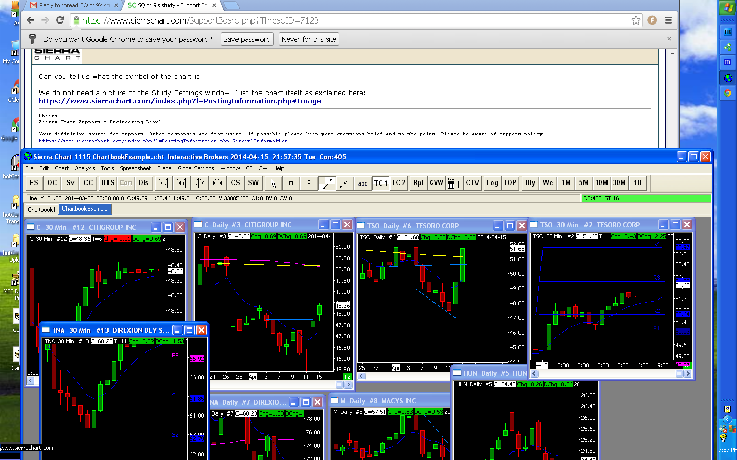

[2014-04-16 01:59:07]
Carol Rutherford - Posts: 66
http://www.sierrachart.com/image.php?l=1397613454543.png
Even thought the sq of 9"s are set up as studies on each of the 30 min charts they don't show on the chart
Thanks for your help

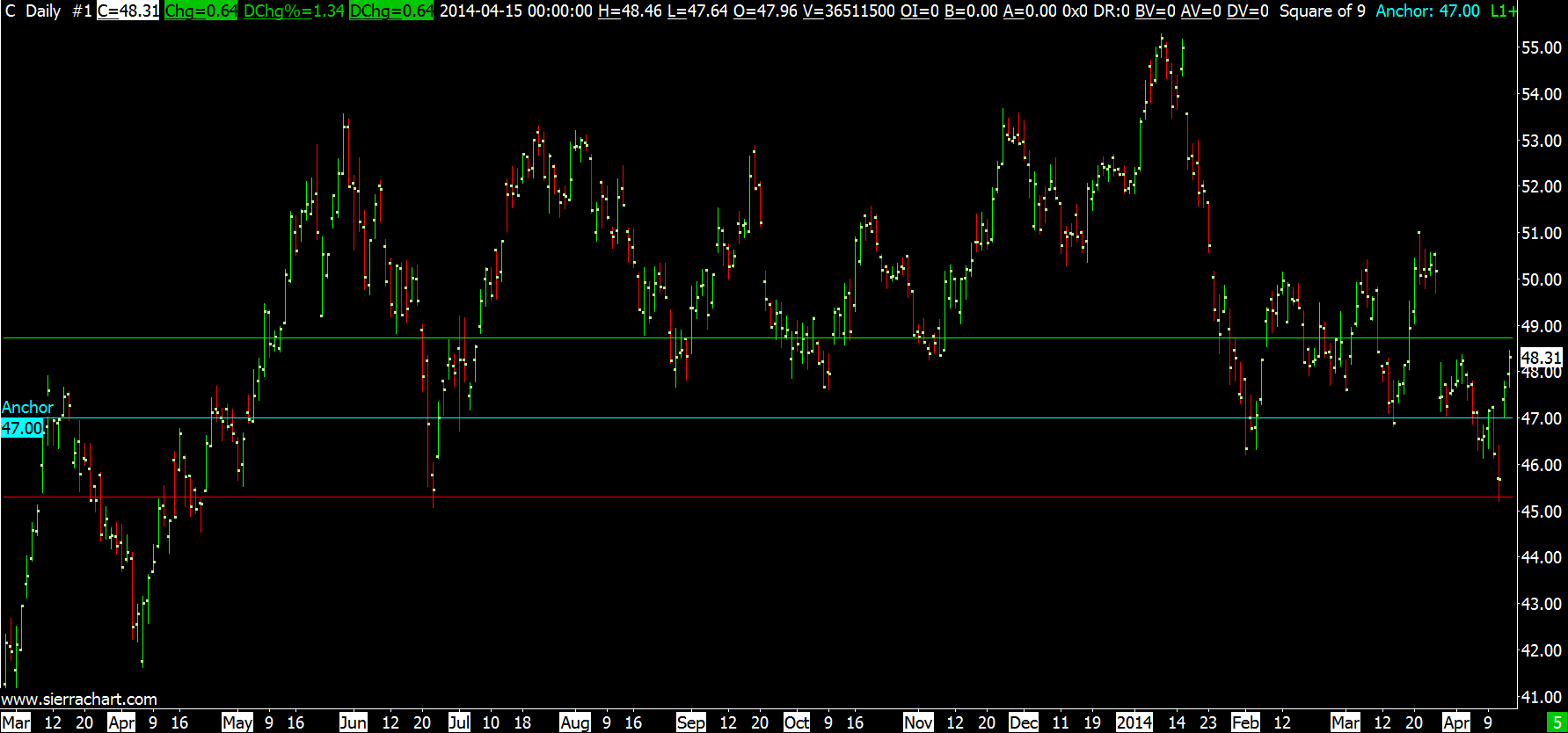

[2014-04-16 08:33:19]
Do you have the Anchor Value input for the study set appropriately based upon the prices of the chart it is on. It should be set to a value which is within the visible range of prices of the chart.
Here is an example:
http://www.sierrachart.com/image.php?l=1397637185594.png
Date Time Of Last Edit: 2014-04-16 18:13:07

[2014-04-16 18:12:44]
The Anchor Value input will be automatically set if it is 0. Therefore, set it to 0.
