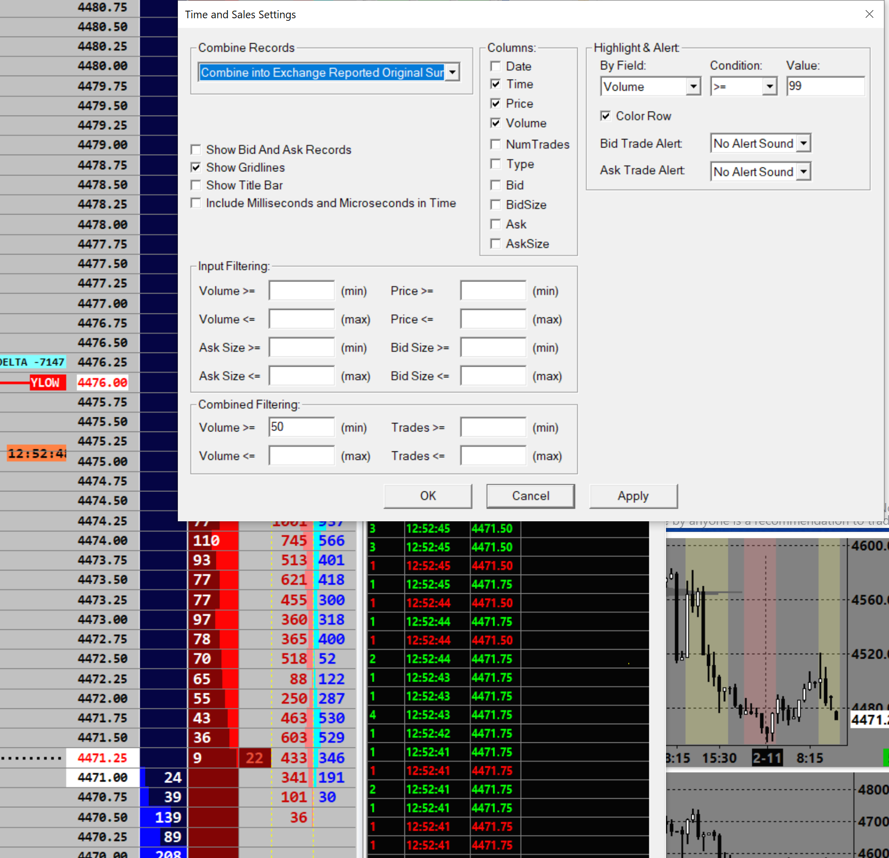

Hello- I do not think my Time & Sales is consolidating the trades into the original order summary. I know these used to work for me but recently they do not seem to be working and do not match the same T&S data when comparing to thee DTN data feed. I know they used to match last time I checked in real time but lately they are not working. I have been using Sierra in the Trading Evaluator mode, if this makes a difference. I do have the Denali Data feed.
Do you know what the issue is?

Do not use an Input filter. Remove that. We are not going to provide any help, when you are setting that, and making things much more complicated.
We will not provide any further help, when you are using filtering.

But I on;y want to see trades that are 50 lot or higher and not all the small trades. Was I doing this incorrectly? When I remove the figures I get 1 lots flying down the tape and I can't read it that way.

If you have Combined the records, then you want to use the Combined Filtering.

Yes definitely do not use any Input Filtering. Only Combined Filtering.

Hello- Yes, but when I do that I get smaller one lot trades. I tired several different ways and do not see what I am doing wrong.Please see screen shot below.

Yes that is true. You do need to use both methods of filtering now that we refer to the documentation.
You are not going to get a match to DTN because DTN does not support combining trades into the original summary. In any case we know that Sierra Chart is doing it correctly.
