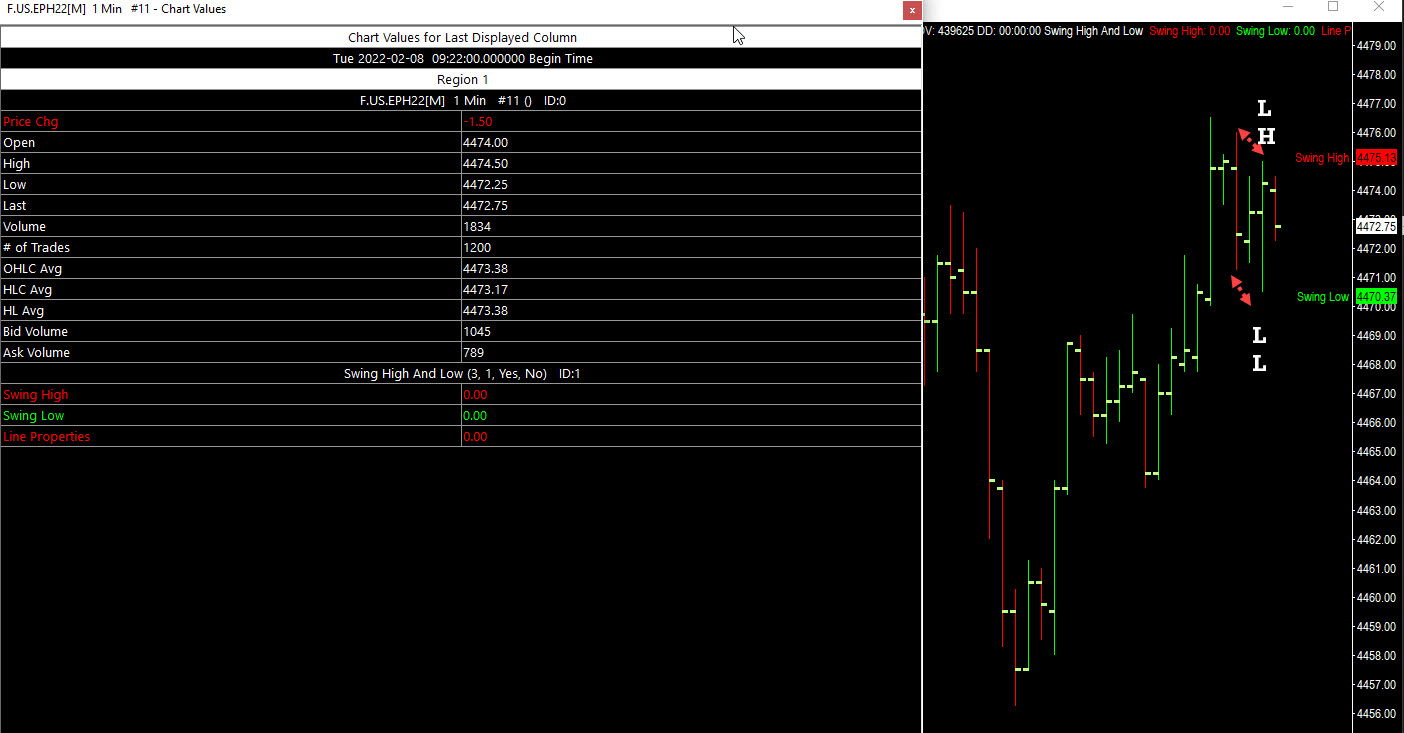

Goal - tracking pivot polarity changes using a pivot script.
The Swing High/Low script does not allow me to access the subgraph values.
Everything is 0
I want to be alerted about the relative Swing high/low to the previous high/low.
Is this Swing High higher or lower than 1 ago?
Is this Swing Low higher or lower than 1 ago?
Search results:
I did find this post regarding holding a value in an array:
How to find all values of an sc.Subgraph[] array that are above a given value?
imageSwing High Low vs 1 ago SC.jpg / V - Attached On 2022-02-08 15:54:16 UTC - Size: 184.31 KB - 312 views
[2022-02-08 16:11:45]
Sawtooth - Posts: 4359
The Swing High and Low study outputs a price at every marker, but not at every bar.
Add the Spreadsheet System/Alert study, and look in column AA or higher to see the study's output.
Use this spreadsheet study to compare the volume at each Swing H.
Use formulas like these:
Cell O3:
=IF(ID1.SG1@3 > 0, F3, O4)
Cell P3:
=IF(ID1.SG1@3 > 0, O4, P4)
where ID1 is the Swing High And Low study.
The volume at the most recent Swing H is in O3, and the volume at the previous Swing H is in P3.
Use K3 to N3 for your comparison alert formulas.
The above is a variation of the example here:
Spreadsheet Example Formulas and Usage: Return Last Two Zig Zag Reversal Values

[2022-02-08 16:27:46]
User337568 - Posts: 65
Tom:
Thank you and, I want the subgraph value and not the volume.
Hopefully, this makes sense.
[2022-02-08 17:26:44]
Then use formulas like these:
Cell O3:
=IF(ID1.SG1@3 > 0, ID1.SG1@3, O4)
Cell P3:
You can use this example to return any value.
