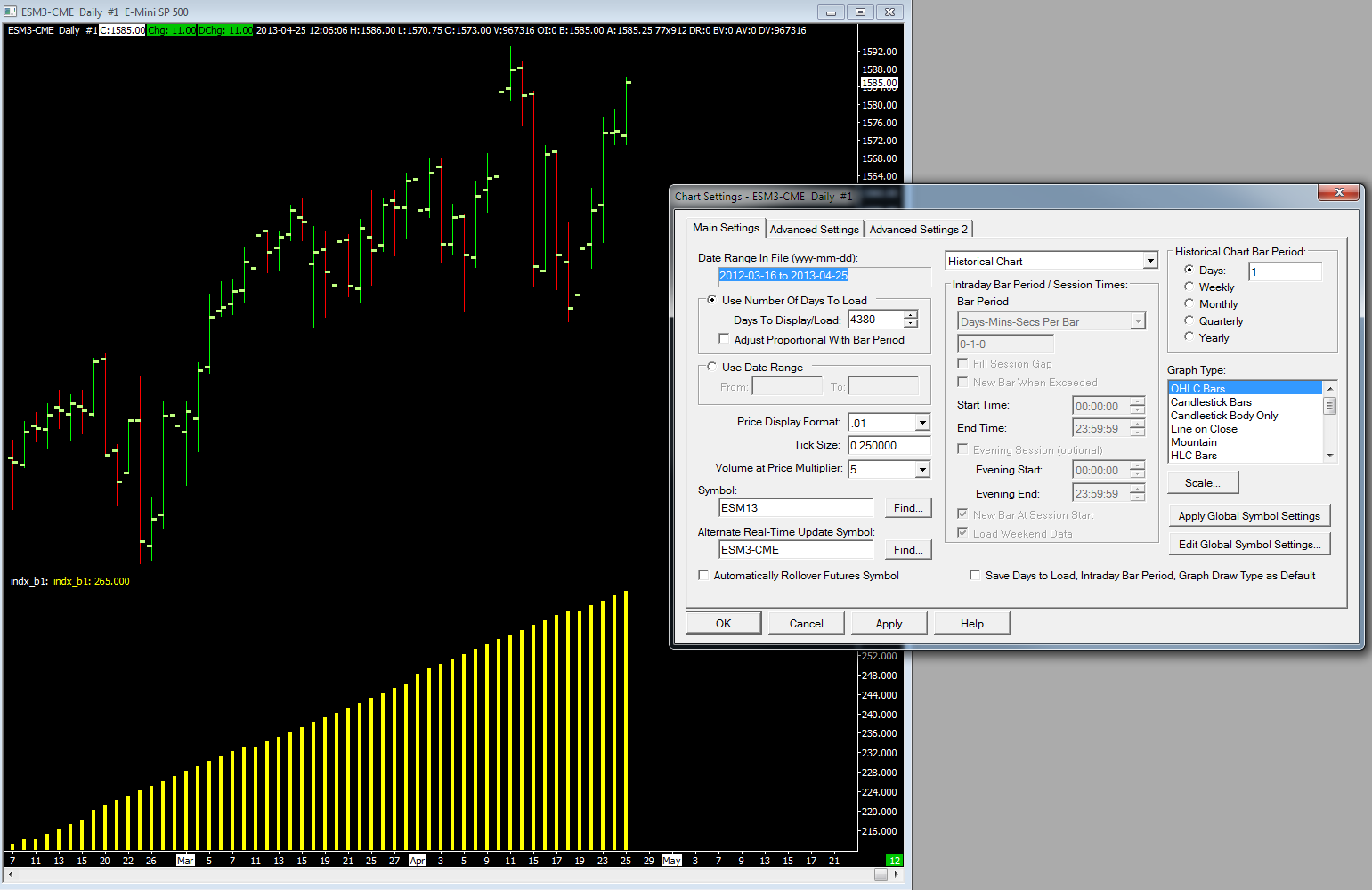

I have a custom 4.8 build and when I test the above code in SC 967 - it works for me.
I have opened the daily chart and inserted the indicator based on the above code as is..
imageSC_Daily_NO_Issue.png / V - Attached On 2013-04-25 15:42:54 UTC - Size: 29.83 KB - 1059 views

Well - I have tried both the options - compiling cpp file with built-in SC compiler as well as using the dll file you have.. worked fine for me.
I couldn't compile the cpp file as is - had to change the dll line ( not that it would matter but - wanted to mention ).
old value:
//SCDLLInit("indx_b1");
New value:
SCDLLName("indx_b1")
Attached is the image & chartbook/cpp/dll(same as the one you sent me).
Edit - I am NOT using continuous contract and my data only goes back to Mar'2013 - and potentially could be the difference..
