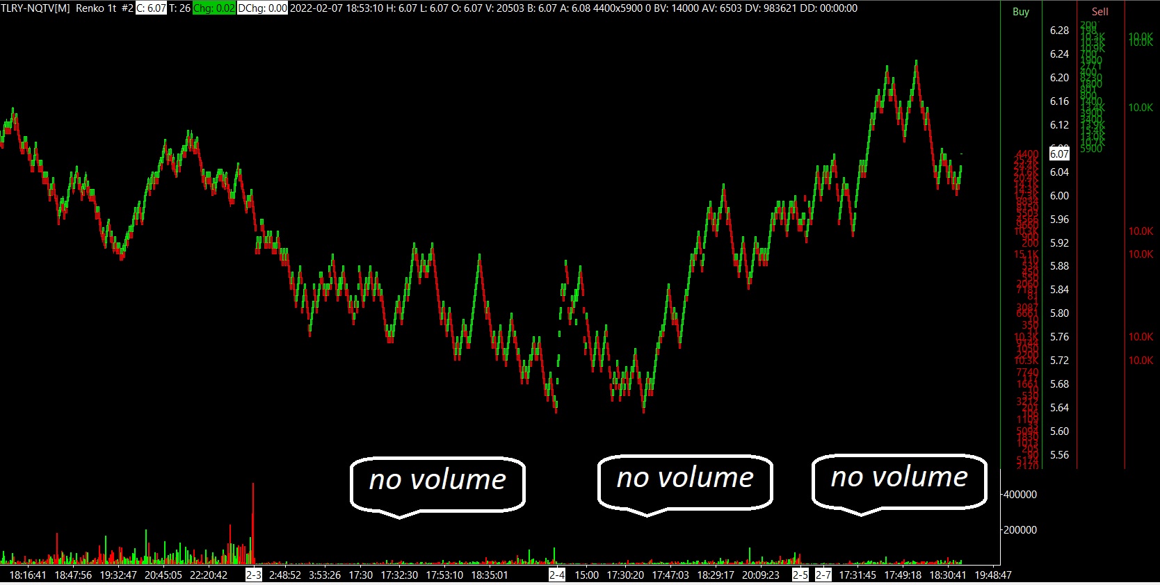

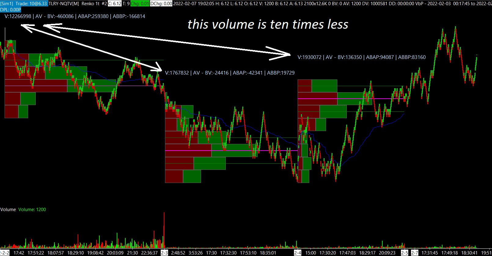

Hello, this is my second time asking this question. There is no volume on the charts, there is no volume in the volume profile tool, the chart is meaningless and empty because of this. How will this issue be resolved? Picture below.
imageto Sch6.jpg / V - Attached On 2022-02-07 16:06:40 UTC - Size: 255.63 KB - 231 views
imageto Sch66.jpg / V - Attached On 2022-02-07 16:06:48 UTC - Size: 287.37 KB - 228 views

What you are seeing is correct. In the chart, where you see higher volumes, that data comes from a different source than NASDAQ TotalView. Since February 3, the data is from NASDAQ TotalView and it provides lower volumes.
We cannot do anything to help with that as it is 100% correct. But do refer to this post:
