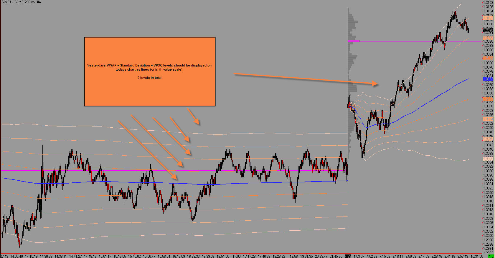

With this study it seems that it's only possible to set two levels for a time span of the current day...?
Could it be a solution to set a chart to only display yesterdays data and then use the study overlay?
I have attached a pic to illustrate what I would like to achieve.
Thanks...
imagevwap_level_transfer.jpg / V - Attached On 2013-04-29 08:12:38 UTC - Size: 194.61 KB - 973 views
[2013-04-29 17:51:01]
joshtrader - Posts: 569
One solution is to set up the source chart with a date range of only the previous day (4/26 to 4/26, for example). Then on the destination chart use the study/price overlay for each level you want to project forward, and set the "fill blanks with last value" to true. This will give what you want, and you only need to update the date of the source chart at the end of the day. This is one option.

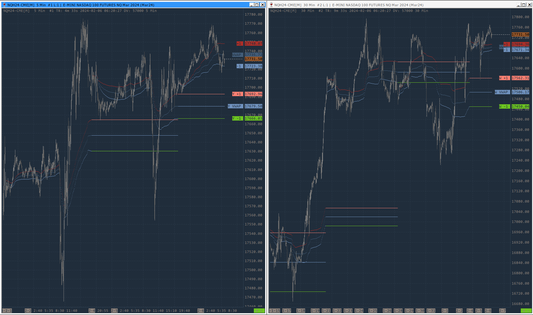

ticinotrader - Posts: 431
@Timokrates
Hope you are doing well!
Just posted a chartbook regarding your question at the below link (you still have full access to my site):
https://www.ticinotrader.ch/extending-vwap/
The solution for me was to reference the individual lines of the VWAP study using the Study Subgraph Reference study, then calculate the last value of the individual reference lines using the Period OHLC/Variable period study and referring back 1 day or 1 week.
Hope this helps.
