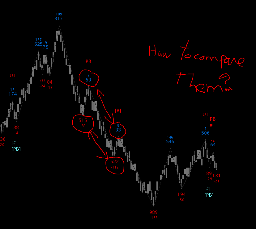

GravisHTG - Posts: 321
See picture and the main things are
[ID2.SG9] Wave Direction --- from 1 to 0 to -1 confirmation are 1 and -1
[ID2.SG15] Wave Total Volume
[ID2.SG18] Wave Delta Volume
So when this wave is Final ( becaues you need to wait for a certain amount of HH or LL ) I want to compare volume and delta to the last time it happen , how to do this ?
I understand How to target the current Swing, but how to target the last one ? that is where i am clueless.
Thanks in advance for the help
Date Time Of Last Edit: 2022-02-03 05:56:02
imagethispictures.PNG / V - Attached On 2022-02-03 05:50:27 UTC - Size: 42.28 KB - 390 views
[2022-02-03 17:25:54]
Sawtooth - Posts: 4359
You would need to use a spreadsheet study employing the concept in this example:
Spreadsheet Example Formulas and Usage: Return Last Two Zig Zag Reversal Values

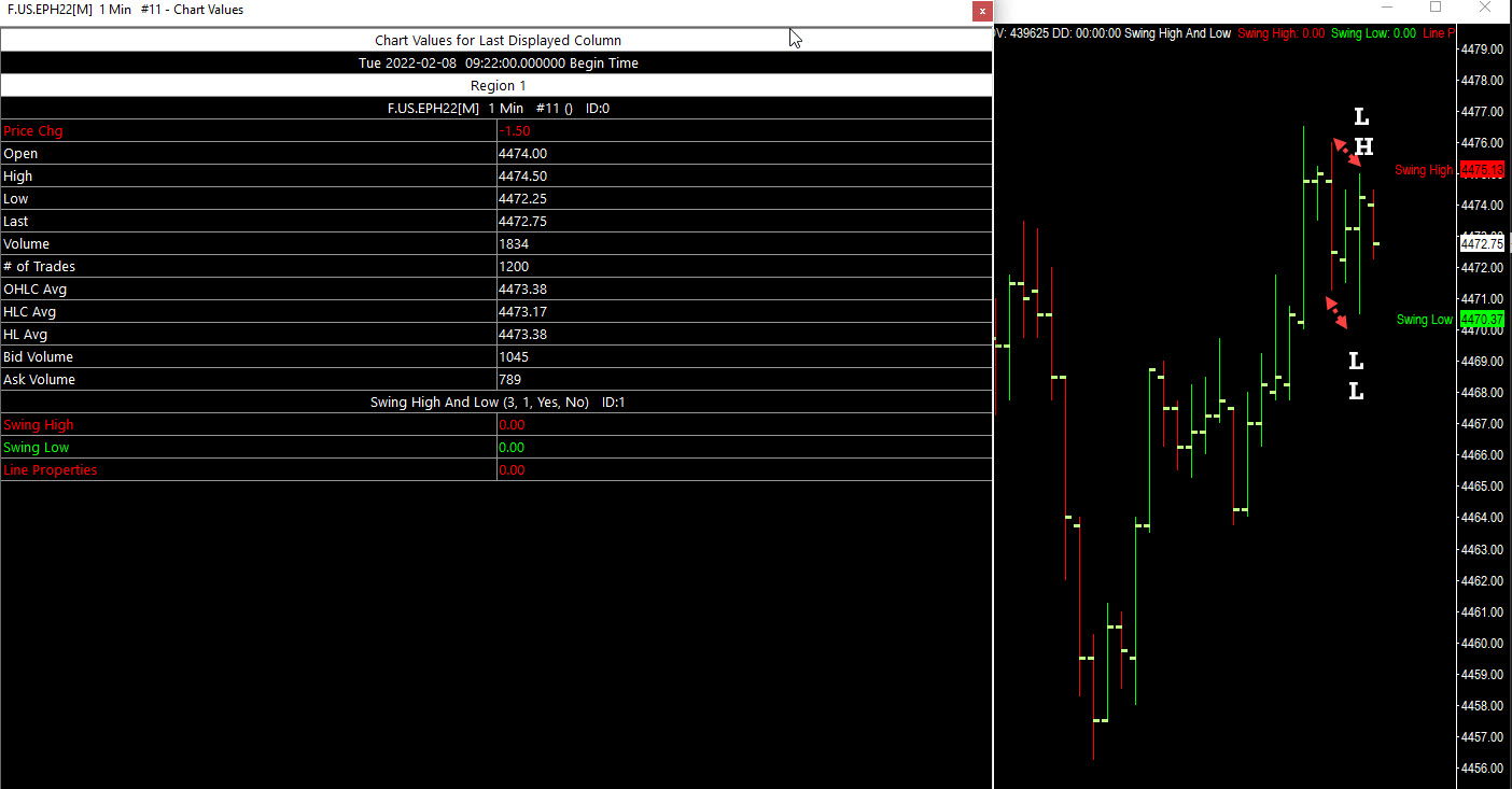

[2022-02-08 15:33:19]
User337568 - Posts: 65
@Tomgilb
Goal - tracking pivot polarity changes using a pivot script.
The Swing High/Low script does not allow me to access the subgraph values.
Everything is 0
I want to be alerted about the relative swing high/low to the previous high/low.
Is this Swing High higher or lower than 1 ago?
Is this Swing Low higher or lower than 1 ago?
Thank you for any help,
Tom
imageSwing High Low vs 1 ago SC.jpg / V - Attached On 2022-02-08 15:32:54 UTC - Size: 184.31 KB - 262 views
[2022-02-08 16:06:22]
The Swing High and Low study outputs a price at every marker, but not at every bar.
Add the Spreadsheet System/Alert study, and look in column AA or higher to see the study's output.
Use this spreadsheet study to compare the volume at each Swing H.
Use formulas like these:
Cell O3:
=IF(ID1.SG1@3 > 0, F3, O4)
Cell P3:
=IF(ID1.SG1@3 > 0, O4, P4)
where ID1 is the Swing High And Low study.
The volume at the most recent Swing H is in O3, and the volume at the previous Swing H is in P3.
Use K3 to N3 for your comparison alert formulas.
The above is a variation of the example here:
Date Time Of Last Edit: 2022-02-08 16:10:54
