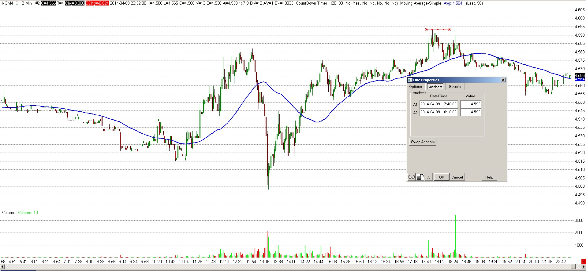

Yesterday i was simulating NG on 2 minutes chart, i am going to paste the chart below of yesterday’s simulation
You will see that 2014-04-09 17:50:37 it was a candle on 4,598 that brokes the previous high on 4,595 marked with a line on red as a doublé top.
http://www.sierrachart.com/Download.php?Folder=SupportBoard&download=2446

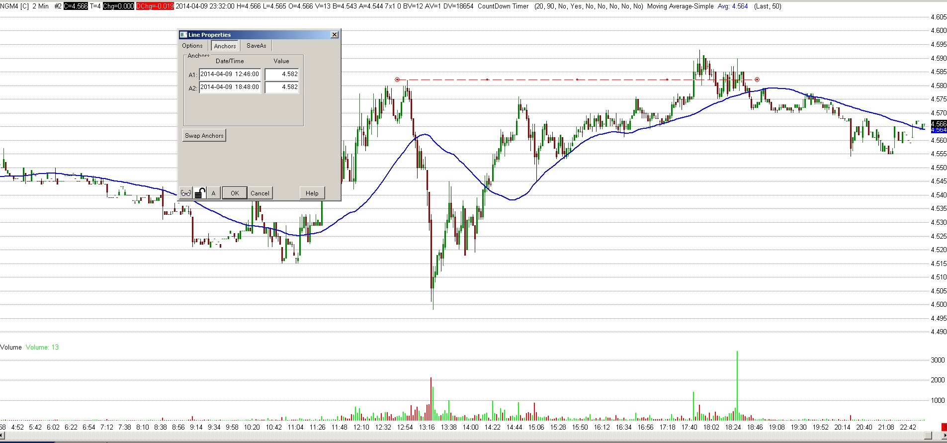

Today i opened the same chart and i have the big surprise that the values of yesterday’s chart are not the same of today’s chart, as you will se below.
http://www.sierrachart.com/Download.php?Folder=SupportBoard&download=2447

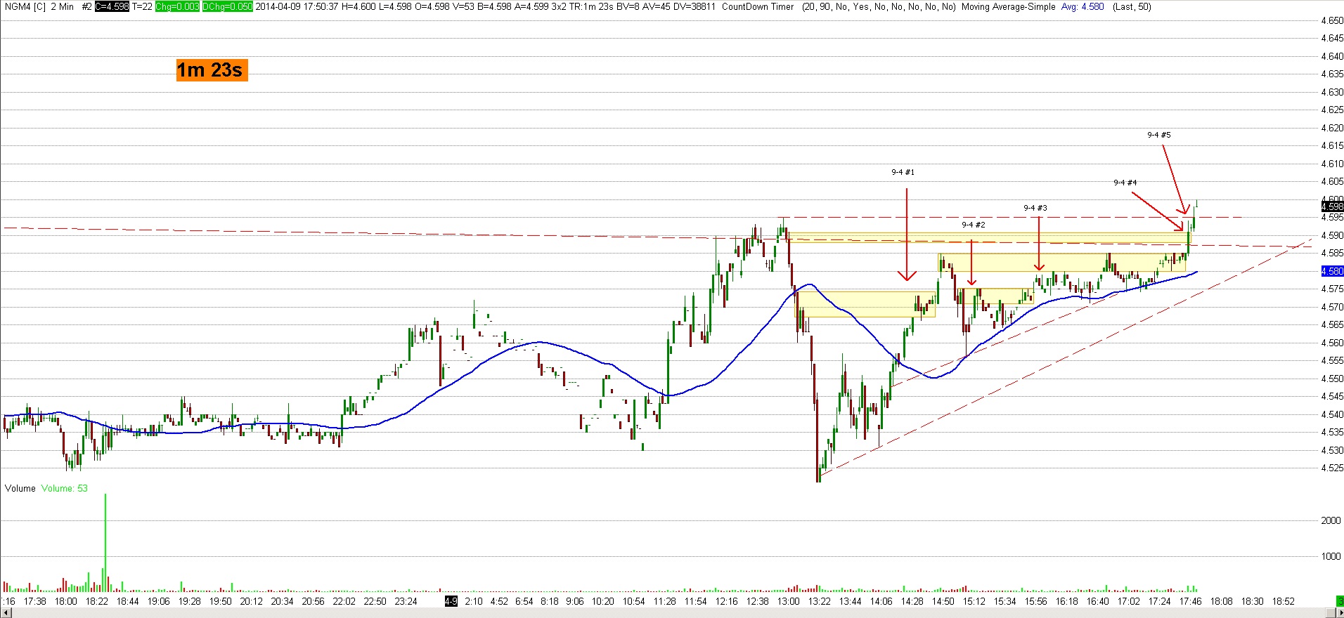

The same candle that yesterday’s high was on 4.595, today is on 4.582, and the candle that yesterday 17:50 was on 4.598 today is 4,593.
http://www.sierrachart.com/Download.php?Folder=SupportBoard&download=2448

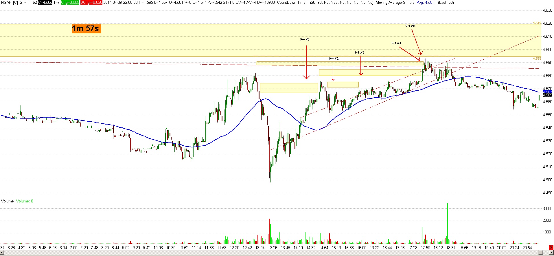

This is yesterday’s chart
http://www.sierrachart.com/Download.php?Folder=SupportBoard&download=2449

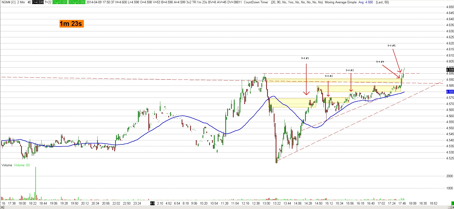

And this is today’s chart, same chart that was saved on yesterday’s sierra charts close.
http://www.sierrachart.com/Download.php?Folder=SupportBoard&download=2450
As you can see it seems that all the charts is down , or all the drawings is up, i know that may be i can have some diference on the drawing positions, but in this case the highs of the candles is different between the 2 days, same candles on different positions. This is very very strange and of course i think is very dangerous if this is a bug or mistake of the program, or may be the wrong one is me and i can’t see if i am doing something wrong.

The June NG contract is not the active contract and you are using the Continuous Futures Contract feature. This is what is leading to the problem. This is explained in detail at item 7 in the Notes here:
http://www.sierrachart.com/index.php?l=doc/doc_ContinuousFuturesContractCharts.html#Notes
Essentially you are looking at two different contract months on 2014-4-9.
