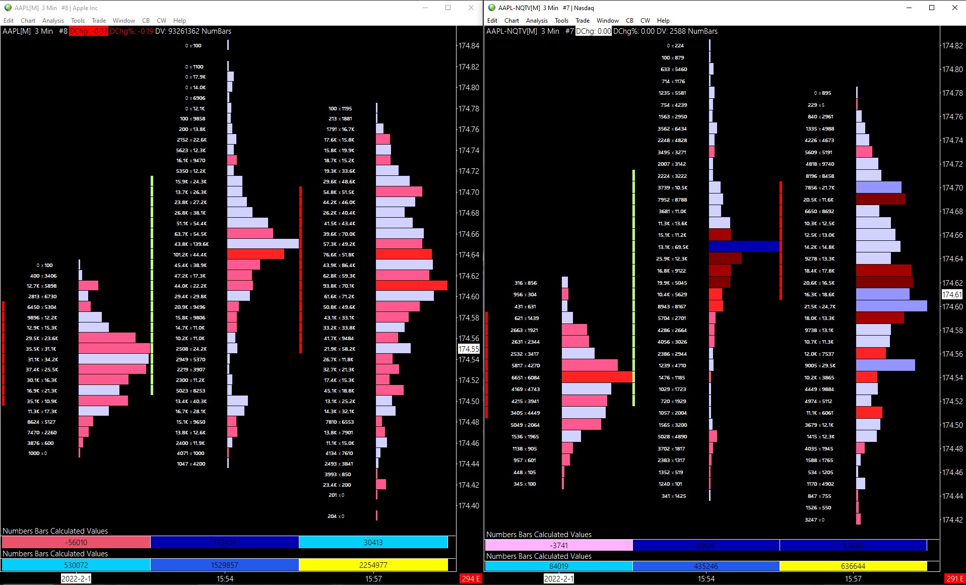

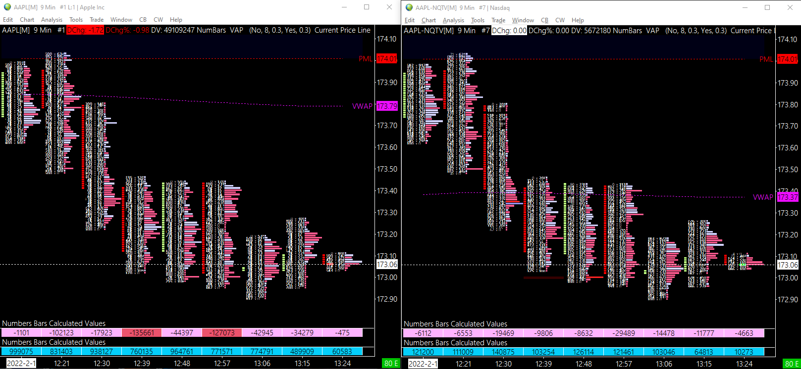

Testing out the new NQTV feed. Have side-by-side of AAPL on the old feed and AAPL-NQTV on the new feed.
9 minute footprint chart. Bar volume totals at the bottom with deltas above them.
Note how much less volume is observed on the NQTV feed.
Any idea what is happening here or how to remedy?
imageaapl nqtv feed comparison.png / V - Attached On 2022-02-01 18:29:22 UTC - Size: 190.88 KB - 351 views

When we did a check previously, we noticed higher volume for NASDAQ stocks, but this was just simply a check at the market open, for one or two symbols.
We will look into this issue further. We are going to make one change and we want to see how it is tomorrow.

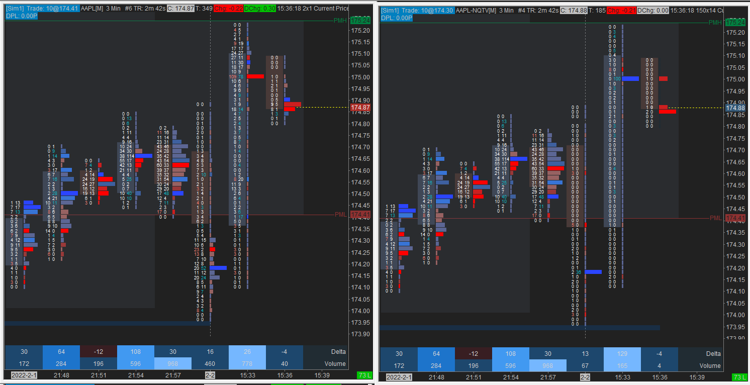

I've attached a screenshot of AAPL on a 3 min footprint at end of day today. The left side is the original SC feed, the right side is the new NQTV feed.
First thing I noticed was the differences in volume on each bar. The 15:57 bar for SC feed is 2.25M shares while the NQTV feed is 636.6K shares. That is a massive difference and the NQ feed is significantly lower.
The bar before that, the 15:54 bar, the SC feed total is 1.53M and the NQTV feed shows only 435K.
I'm wondering if you're able to see the same results as I do above?
My thesis here is that the NQTV feed volume is coming over as one tenth of what it actually represents. Please see the following screenshots for supporting evidence of this:
The NQTV feed's 9:30am AAPL 3-minute bar shows only 400K but actual volume was closer to 4M. This means the NQTV vol is coming over as one tenth of its actual volume, right?
Edit: Unless there's some other setting I have set (in global symbol settings?) that's causing this? Would need confirmation from other SC users trying to repro this.

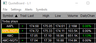

But there seems like to be an issue with premarket volume. Or it has to do something with quote board. Although volume study on chart is showing 0.
Will observe volume after market open.
Please see the picture attached.
Took at 8:30AM ET
imageQBPreMarket.png / V - Attached On 2022-02-02 13:33:40 UTC - Size: 11.16 KB - 316 views

Sorry I meant normal symbol without -NQTV. Symbol from existing stock data.
My footprint chart has only RTH session on. So premarket I saw yesterday's session and AAPL and AAPL-NQTV had same volume.
But after session started today, there are some differences. Please have a look on attached screenshot.
Left chart is AAPL and right is AAPL-NQTV.
21:57 bar is when yesterday's session ended.
2-2 bar is today's open
I have set volume multiplier for both symbols to 0.001. So thats why volume per bar looks low.
With volume multiplier set to 1:
AAPL at session open bar did 925k volume
AAPL-NQTC at session open bar did 264k volume
imageFPDiff.png / V - Attached On 2022-02-02 14:50:42 UTC - Size: 128.75 KB - 271 views

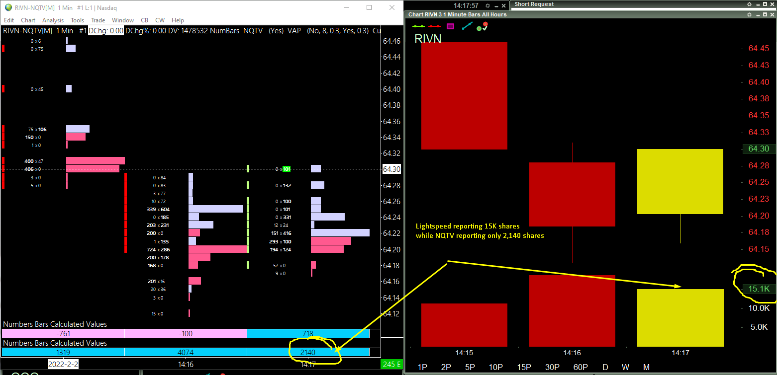

Just wanted to report back that I'm still seeing oddities. Here is one example:
RIVN ls vs nqtv.png ---> 1 min candles on RIVN. Lightspeed reporting 15K shares and NQTV only reporting 2K.
Looks like there is a release going out tonight that may address some of this based on this thread:
How to Use New NASDAQ Total View Data Feed | Post: 293994
imageRIVN ls vs nqtv.png / V - Attached On 2022-02-02 19:20:00 UTC - Size: 104.29 KB - 301 views

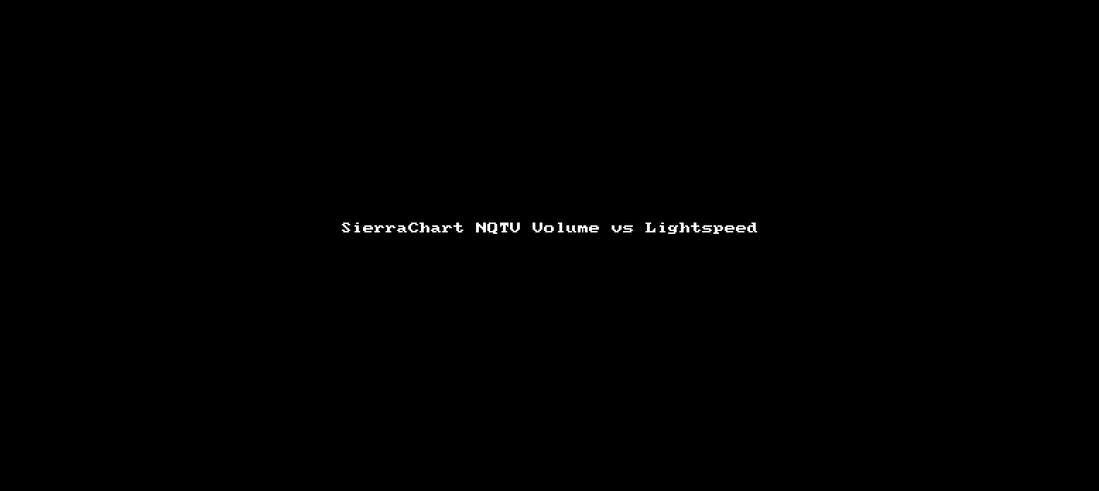

1 minute NQTV volume compared to 1 minute volume bars from Lightspeed direct access broker platform.
The volume totals are significantly different from each other, NQTV reporting roughly one tenth of the volume that Lightspeed is reporting.
Wondering if anyone else is seeing this, on any other platforms, or is it just me?

ev_er - Posts: 1
Frozentundra - you're not only one seeing this.
I have compared -NQTV volume of some stocks with the volume from other sources and it is as you are saying - -NQTV volume is about 1:10 lower :/

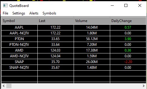

[2022-02-08 15:22:44]
frozentundra - Posts: 102
@MalyKubo - yes, seeing the same here. All the NQTV symbols are significantly lower/wrong on the daily volume amounts compared to the SC feed.
I'm going to need to switch back to the old feed until this is addressed/resolved, the difference in volume is too significant.

[2022-02-08 15:57:20]
We do not think there is anything to resolve here. It would be unlikely there is anything wrong. This is the volume that the NASDAQ TotalView data feed is providing.
