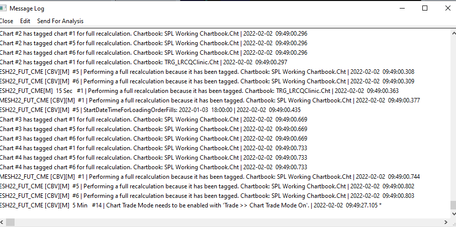

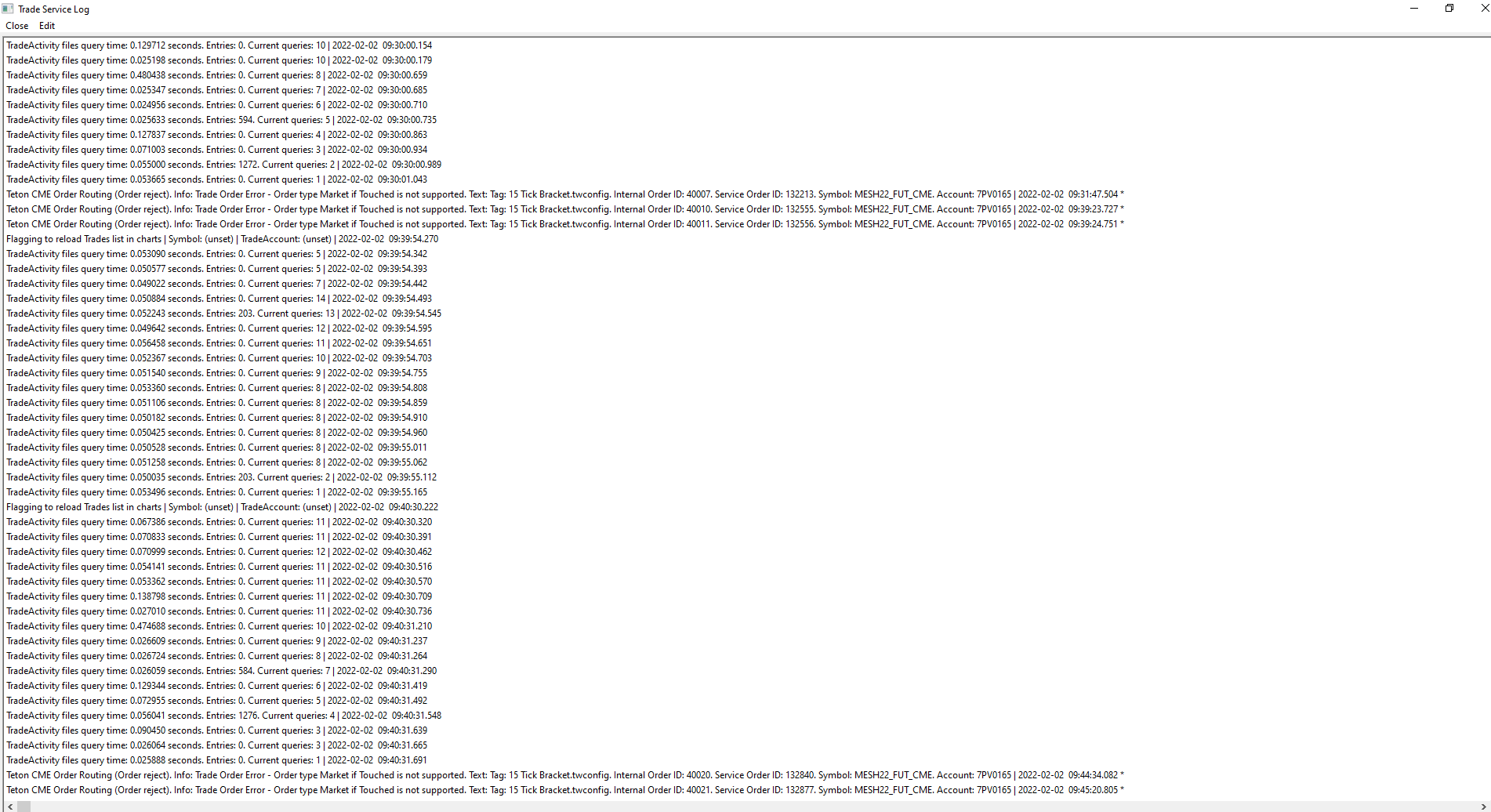

So i switched to Market order if touched and it seemed to work on a couple of trades (SIM and Live) and then it stopped working and gave me an error message stating that he order was not supported. I will attach a screen shot of the service log
The other problem i ran into was that to circumvent the issue of the market orders i assigned hotkeys to a numeric pad which works without problem. I was again able to place several (SIM and Live trades without any problems then suddenly i started getting error messages the first was that the trading shortcuts needed to be enabled (which it was). So i unchecked and then rechecked on the Trade DOM. Then i got a different error message stating that the Chart trade DOM needs to be on. I looked for the chart they referred to in the service log and could not find it (also will attach service log)
At this point it seems like my only choice would be to go back to Market order if touched client if i want to use the mouse since the two other market order types are not supported.

[2022-02-02 18:45:32]
With regards to the "Market if Touched". For the Teton Order Routing service it is noted that this is not supported in this section:
Sierra Chart Teton Futures Order Routing: What is Included
Still, you could use the "Market if Touched - Client" instead, which keeps the order on your local system until touched and then puts in the Market order to the exchange. You just have to ensure that your system is on, running, and connected properly to ensure that the order gets placed. Refer to the information here:
Order Types: Market if Touched - Client
With regards to the Keyboard Shortcuts, it is referring to Chart #14 which has the symbol "ESH22_FUT_CME". If you do not see it in your tabs, then go to the "CW" menu and find it in that list. Even if it is hidden, it will be there and you can select it to "unhide" it.
