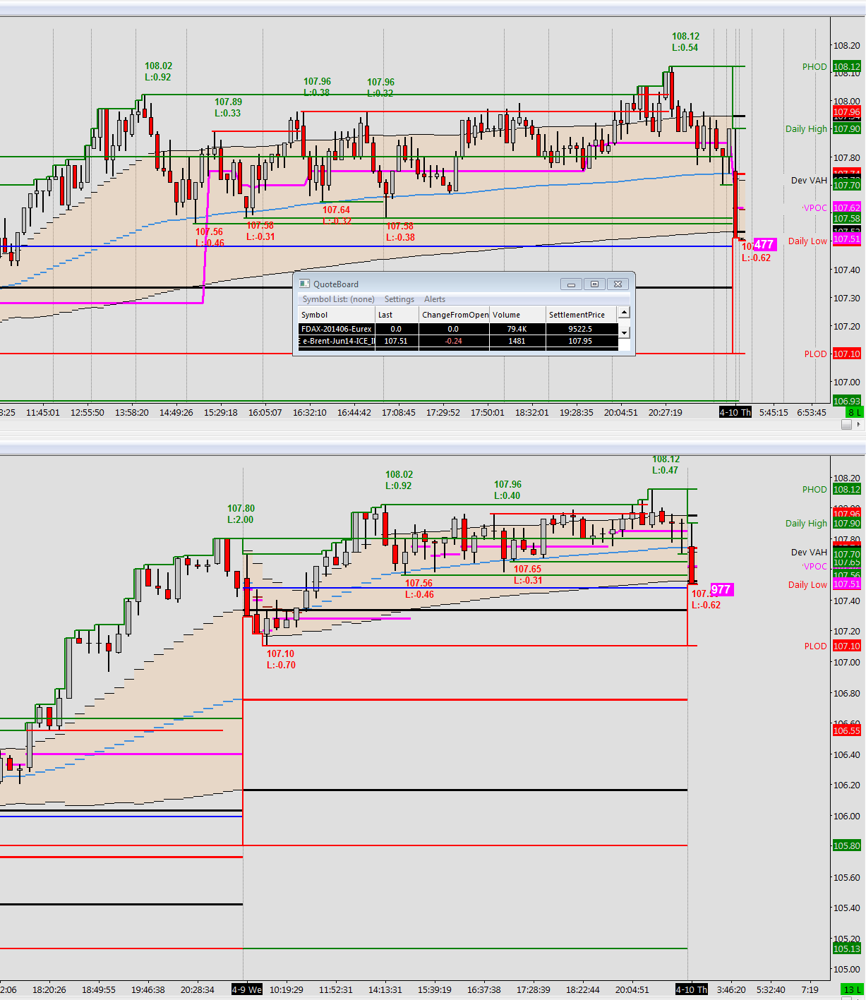

i have a question regarding the volume shown in the quote board and the volume shown on my chart.
quote board says 1481 contracts traded, but charts (upper chart shows 500 volume bars, lower chart 1500 volume bars)
showing only 523 contracts traded ( 1 500 volume bar finished, and 23 contracts traded in second bar).
im confused, can you please clarify.
imagevolume.png / V - Attached On 2014-04-10 03:12:43 UTC - Size: 102.54 KB - 649 views

This question is well outside the scope of our support. You need to understand our perspective on this. Unless we are presented with a Historical Daily bar chart with the volume study below, we are not going to try to figure this out. There are millions of things users can do with Sierra Chart and millions of problems users can create for themselves and millions of confusing things that can be created. And we do not try to figure out these millions of things.
In general the kind of comparison you are doing is not valid as explained in help topic 43.7:
https://www.sierrachart.com/index.php?l=doc/helpdetails43.html#h43.7
Support policy:
https://www.sierrachart.com/index.php?l=doc/PostingInformation.php#GeneralInformation
Date Time Of Last Edit: 2014-04-10 03:55:36

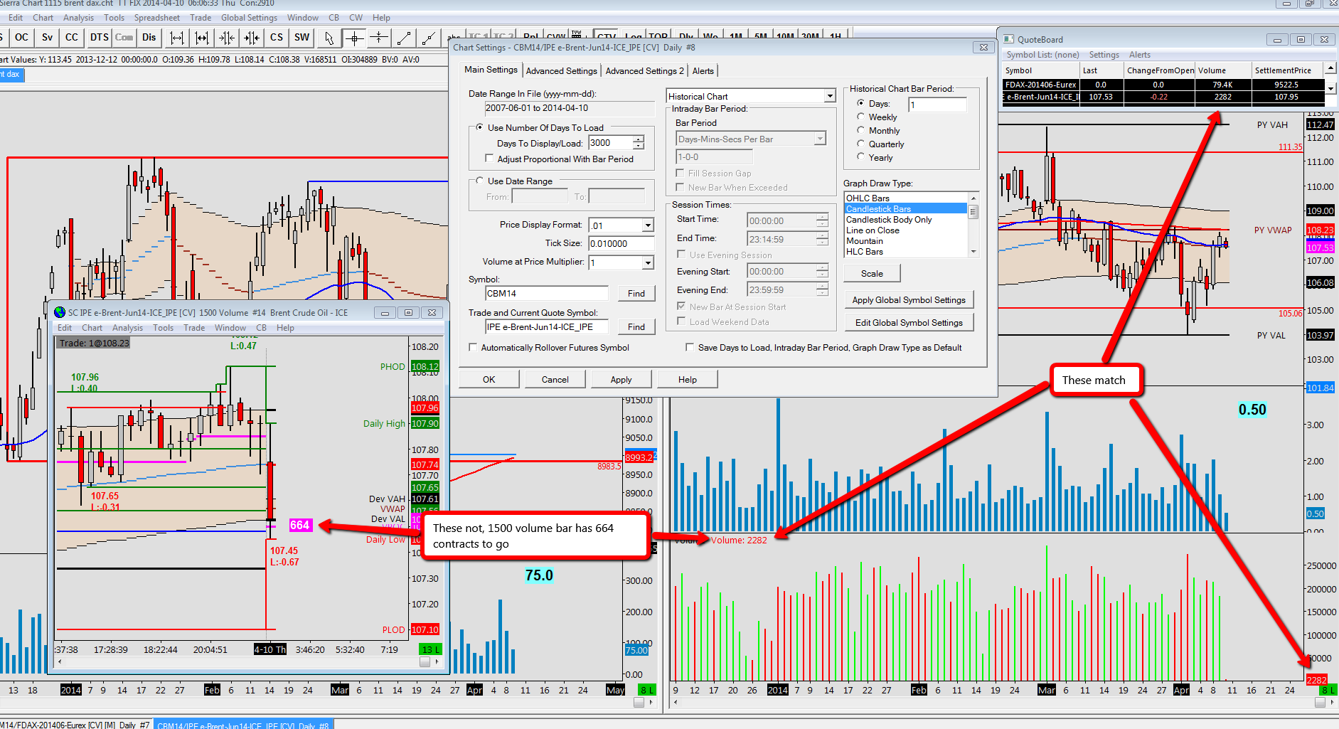

heres the daily historical chart.
not nessecary to figure out these millions things.
it should be very simple for you to pull a 1500 volume chart with tt fix price feed and compare the volume to what quote board says.
if you get same result, it cannot be a MILLION things going wrong.
NOTE: MORE TRADED CONTRACTS MISSING COMPARED TO TRADED CONTRACTS SHOWN ON CHART
imagevolume_2.png / V - Attached On 2014-04-10 04:24:40 UTC - Size: 217.46 KB - 638 views

Here is a properly configured chart with 1 day per bar, for ICE Brent following exchange specified session times:
http://www.sierrachart.com/image.php?l=1397114797720.png
You can see from the compact tool values window, the calculated volume from the most recent Intraday chart bar is significantly less than the exchange reported Daily Volume from the Current Quote Window.
As help topic 43.7 explains, this is from spread trading.
Date Time Of Last Edit: 2014-04-10 07:31:24
