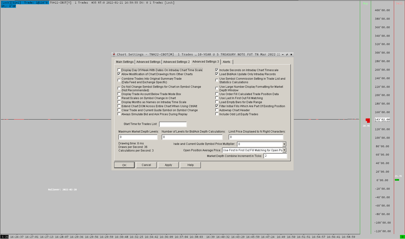

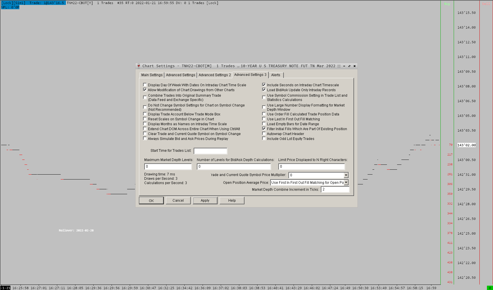

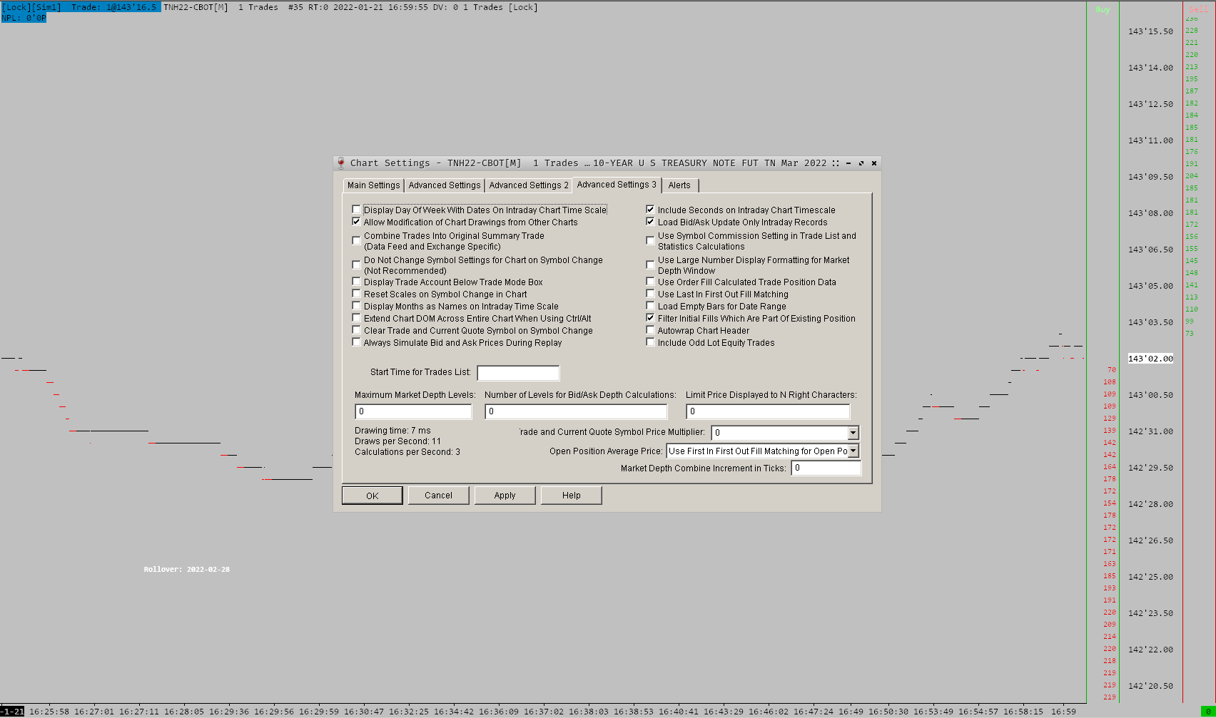

ticinotrader - Posts: 431
Dear Support,
I was just about to report the same issue - it exists across all symbols I tried (including futures, BitMEX) and appears to be an issue after updating to 2348. I am using SC All Data.
Greater than 0 value at Chart Settings >> Advanced Settings 3 >> Market Depth Combine Tick Increments results in seemingly missing Ask side of the depth. Actually, it is not missing, but it is far below the bid side.
Please see the attached screenshots.
image20220123-172100.png / V - Attached On 2022-01-23 16:23:32 UTC - Size: 74.13 KB - 306 views
image20220123-172116.png / V - Attached On 2022-01-23 16:23:38 UTC - Size: 64.55 KB - 276 views
image20220123-172137.png / V - Attached On 2022-01-23 16:23:43 UTC - Size: 61.64 KB - 263 views
