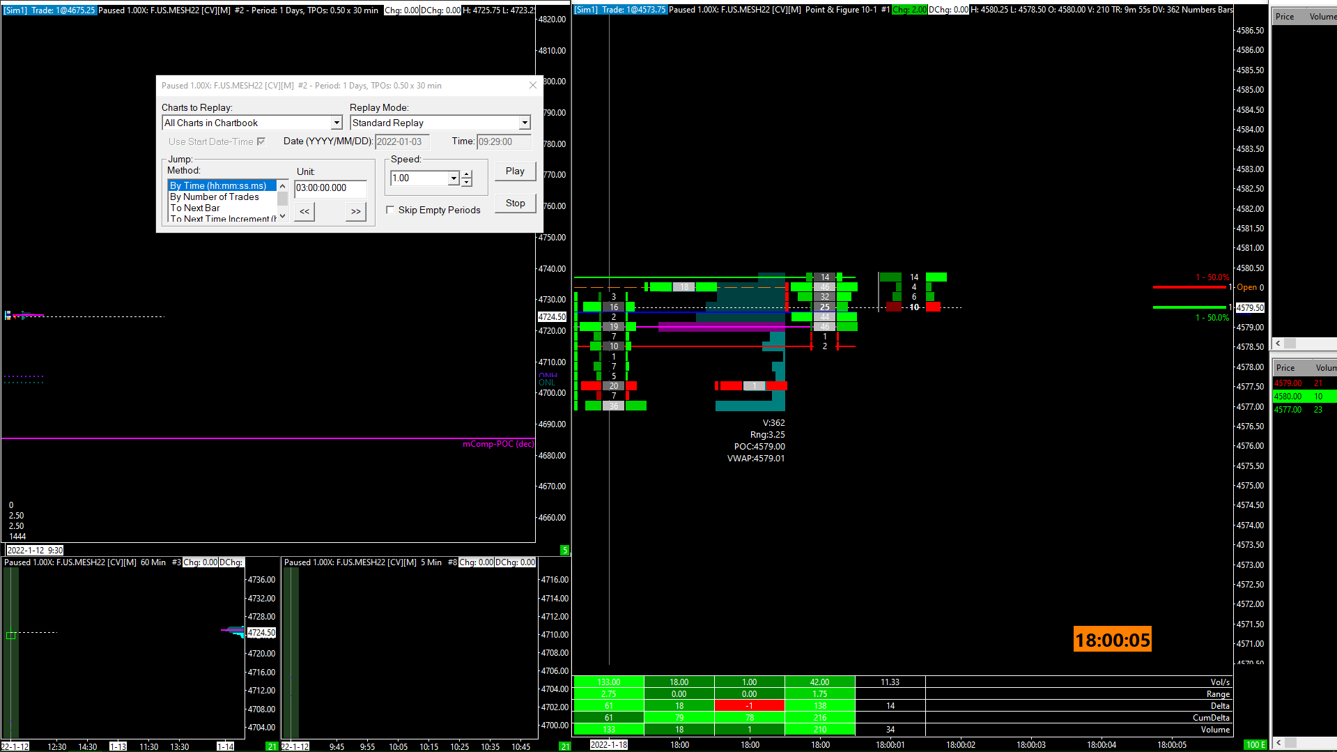

I'm having some issues getting market replay to work correctly when selecting date/time further back than about 2 days.
- I use CQG through AMP for trading and the Denali data feed for data. I followed the setup instructions and all of this works fine
- the symbol F.US.MES is set to record market depth data. (Could there be an issue with the way symbols get mapped across cqg/denali?)
- replay set to all charts in chartbook.
- using a date/time within the last 2 days works fine
- using a date/time further back does not work correctly:
ex: I set market replay to start at 2022-01-03/9:30AM:
- 1 chart starts at 2022-01-18 / 18:00
- other 3 charts start at 2022-01-12 / 9:30AM
Thank you.

flowlogr - Posts: 11
As far as I can tell, I do have data in those charts for the days I'm trying to select.
It's everything that's not showing up.... As shown in the image, different charts go to different (incorrect) days.
For instance, I just made sure all charts have at least 40 days loaded.
Set replay to 1-4-2022 9:29AM.
My intraday footprint chart went to 1-23-2022 18:00, and my market profile went to 1-03-2022 16:59
Same basic outcome as other efforts.
