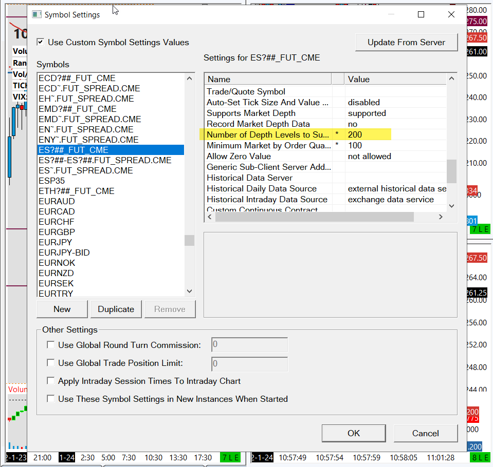

@Bootsy, I think I know what you are talking about as I ran into the same issue. By default, when you activate market depth data, you only see 100 levels, 50 per side (I could be wrong with the numbers). So if you are using the Denali data feed, you actually have access up to 1400 levels. You have to go into Global Settings >> Symbol Settings for your instrument and manually modify this value. I changed mine to 200 (100 per side) for the /ES and that works perfectly for me. Anything outside of that is not in my timeframe. Let me know and I can send a screenshot of the config.

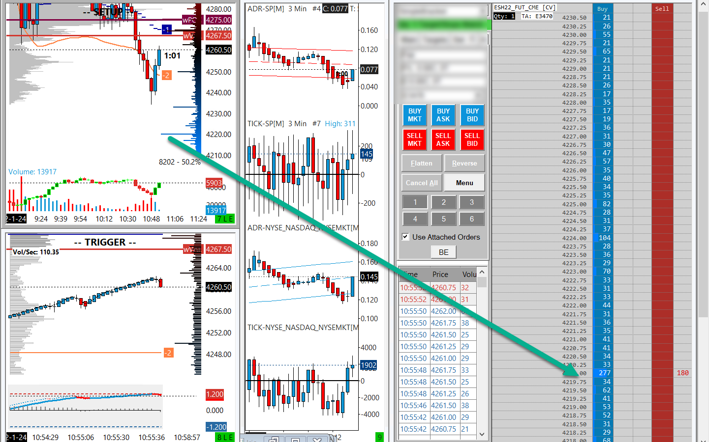

[2022-01-24 17:13:36]
traderacefly - Posts: 57
You're welcome. Hopefully we are talking about the same thing. I wanted to see multiple levels of the order book that were not necessarily visible on the DOM or chart because they were too far away. I attached a screenshot of an example. Not a great example from today because the order book is thin but it should show the perspective that I am referring to. The other is the symbol settings you'll need to modify, Global Settings > Symbol Settings. The example on my 3-minute chart shows a "large" order 60 points away. You'd never see that on a range or shorter time frame chart without scrolling for it.

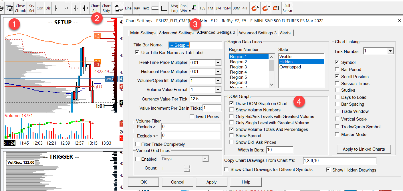

[2022-01-24 19:20:11]
Hey Bootsy, I don't use that bookmark style market depth. It looks cool but I found it was not terribly useful, to me. But to get the order bars on the chart is easy. Select the chart you want to display the bars onto and on the menu bar click Chart Set > Advanced Settings 2 and select Draw DOM Graph On Chart. There are a few parameters there you might like to try. I only need to see volume totals/percentages on the ends. Screenshot attached.

[2022-01-24 19:57:11]
bootsy - Posts: 63
Wow that's amazing, thankyou so much acefly! That's a real game changer to see orders represented in such an easily identifiable way!!
