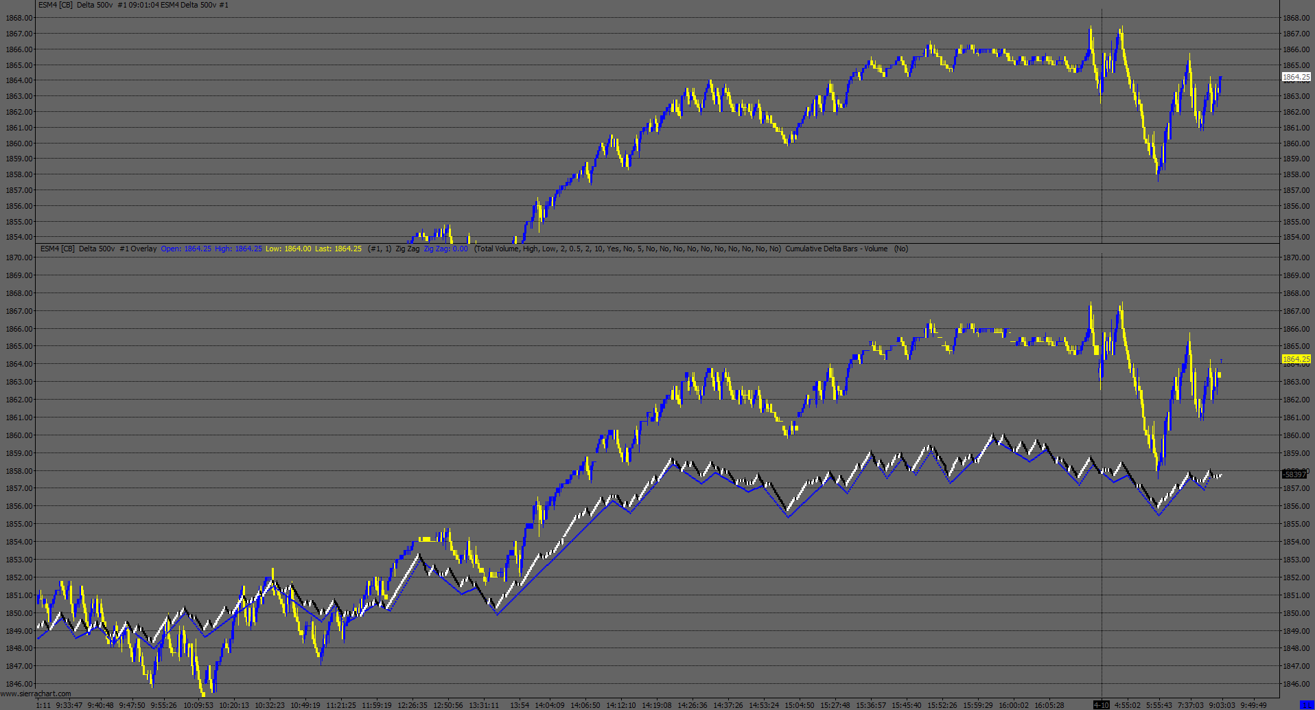

MonteCarlo64 - Posts: 23
http://www.sierrachart.com/image.php?l=1397052481210.png
I have this chart set up exactly the way I want with both the ESM4 and CDV in the same chart region (saves real estate) with different scales on the left & right axes, but there are no zigzag labels with zigzag applied to the CDV chart. I need to see the labels for CDV pivots to be able to set audible alerts.
[2014-04-09 17:19:39]
Yes, this does make sense. The labels are not going to work properly with this kind of configuration. And we can definitely not support that.

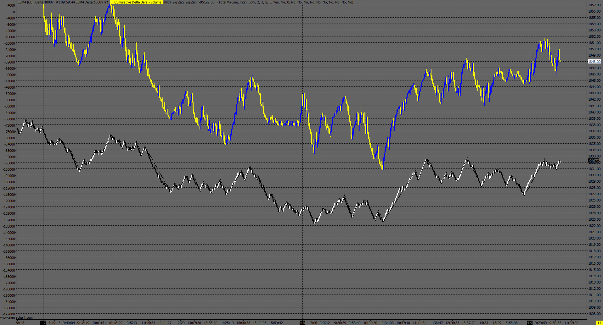

http://www.sierrachart.com/image.php?l=1397069899124.png
I have an alternate approach to get what I want but now I would like the right side axis to be the ESM4 price instead of a repeat of the left axis for the CDV value. Can you provide a means where the user can choose to make optimal use of both left & right side axes NOT conveying the same redundant info but providing twice as much info. I am sure other users would find this very useful and allows saving real estate.
[2014-04-09 22:04:55]
You should be using the Overlay (Bar) study to do the overlay.
And make sure that study is at the top of the list of studies.

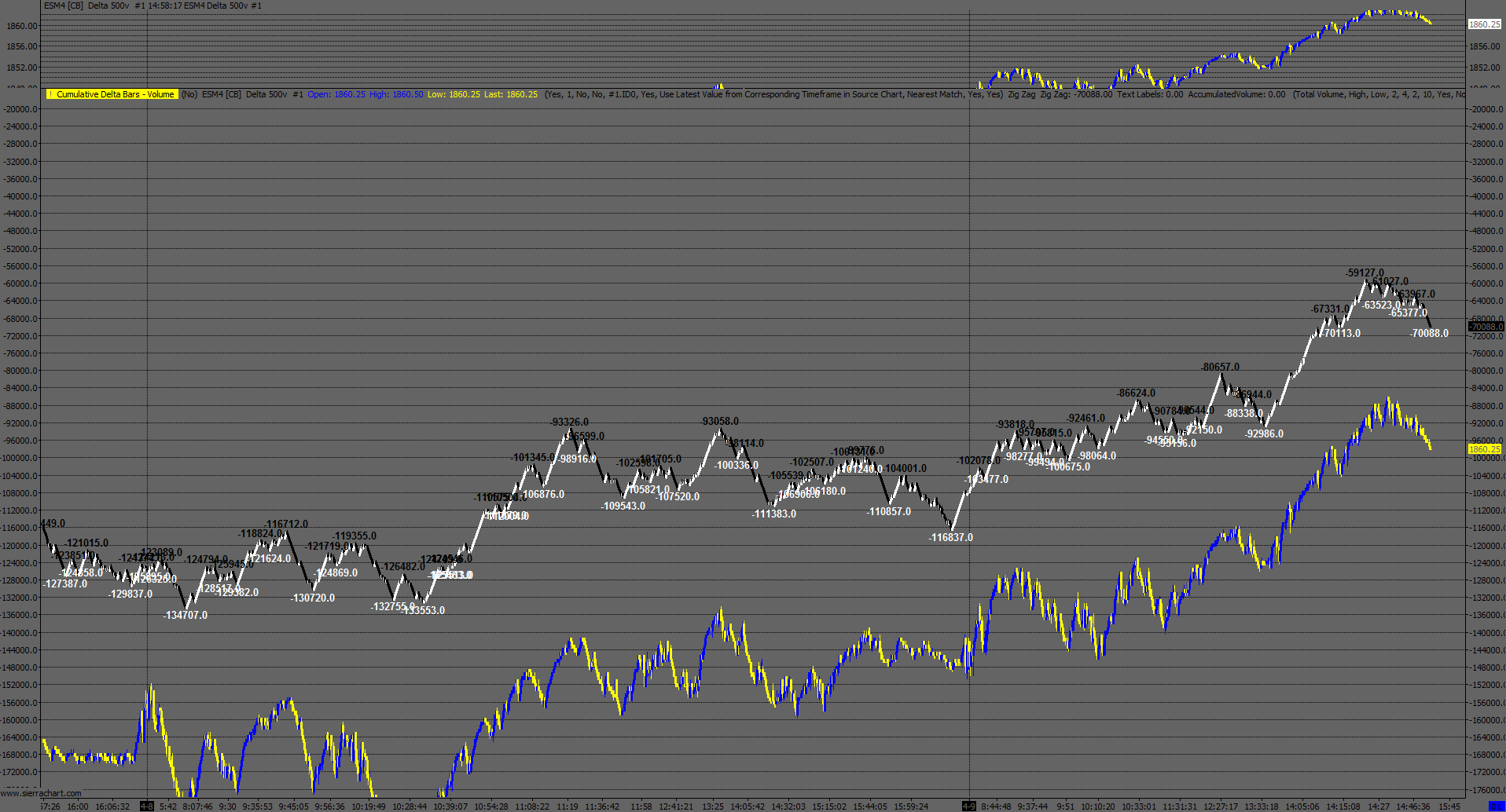

http://www.sierrachart.com/image.php?l=139713486629.png
That is even worse because not only do I not get the left axis with the CDV values and the right axis with the ESM4 price, but I no longer have the zig zag labels for the CDV values at pivots that I had previously.
[2014-04-10 17:04:18]
The documentation for how this works is here:
https://www.sierrachart.com/index.php?l=doc/doc_ChartSettings.html#UseLeftSideScale
Do the following:
Make the Cumulative Delta Bars the first study. Set the scale for this to "Automatic". Refer to documentation here:
https://www.sierrachart.com/index.php?l=doc/doc_Scaling.html
Make the Overlay study the second study. Set the scale for this to "Independent".
