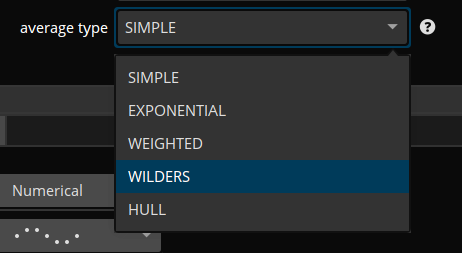

Anyway, I am currently using Kiwi's trailing stop and it is a wonderful indicator. However, I would like to make it more similar to the ATR Trailing Stop offered in Thinkorswim and that is the ability to select the average type that we want to use toward the ATR calculation (see picture).
After reviewing the source code for Kiwi's trailing stop, it seems that he had hard coded the calculations to be using the Wilders method (if I'm not wrong). Is there any easy solution for me to change it to using the Simple method?
Unfortunately, I am not very proficient in coding nor C++, I can only edit basic coding so I have to ask for your help. Very much appreciated.

imageTOS ATR example.PNG / V - Attached On 2022-01-17 20:59:45 UTC - Size: 11.68 KB - 456 views

Kiwi - Posts: 375
In the code you'll find two lines (spaces may be different but):
Subgraph_diff2[pos] = max(Lref , max(HiLo, Href));
sc.MovingAverage(Subgraph_diff2, Subgraph_atrmod, MOVAVGTYPE_WILDERS, pos, period);
Just change MOVAVGTYPE_WILDERS to MOVAVGTYPE_SIMPLE to change the moving average type.

tuanluu20902 - Posts: 24
Thanks a lot for the help kiwi! Yeah I thought of that solution but really did not know if that would do it since I did not understand half of your codes haha.
