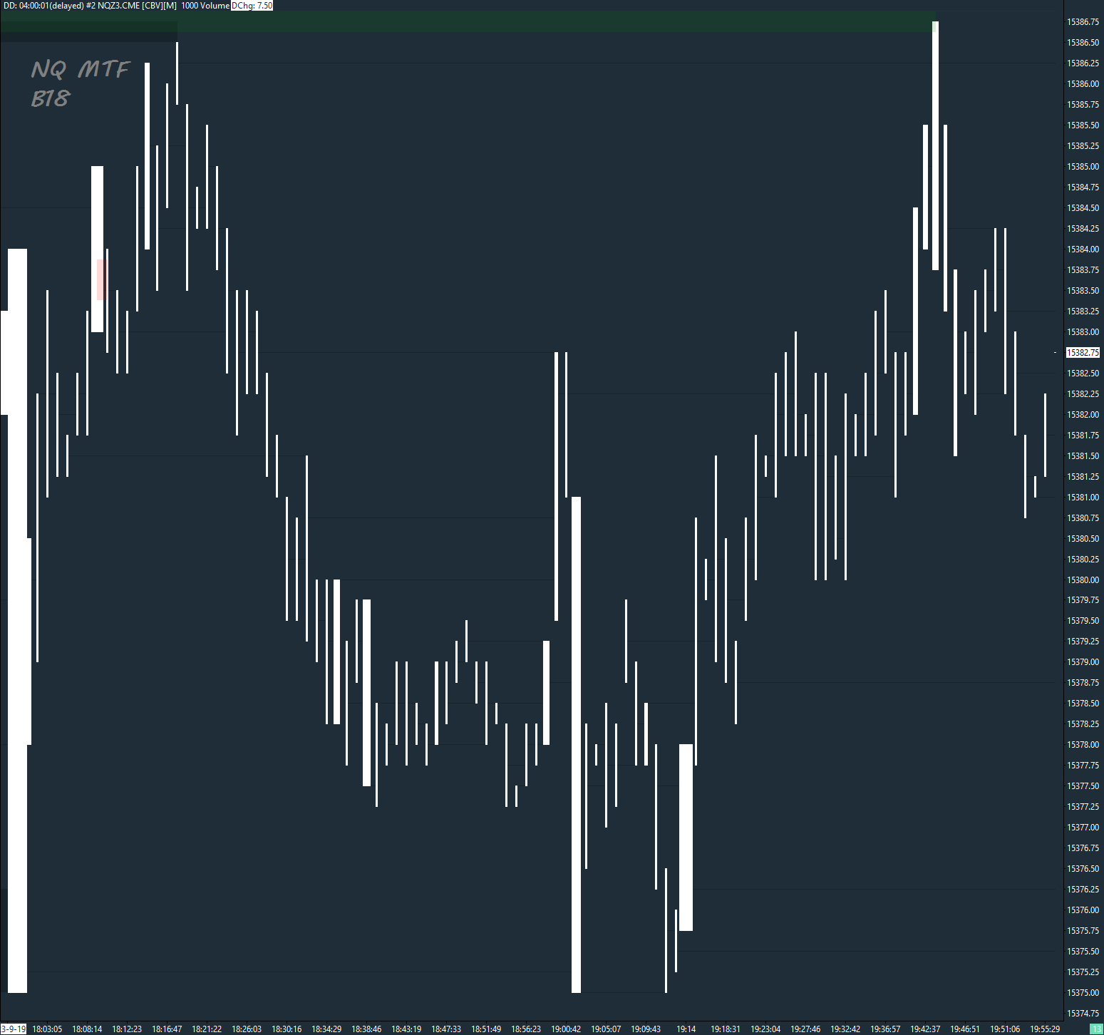

Thanks for asking. When a candle of Graph Draw type: "Candle Price Volume Bars" is selected, some candles are thicker in width than others to depict the relatively larger volume in that candle. Other candles are narrower in width to depict that lack of volume that occurred there. https://www.sierrachart.com/image.php?Image=1695167803639.png I'm wondering if ASCIL provides a function to the user when making Custom Bar Charts to enable the thickness of the candle to refer to an underlying data such as Volume, or other data for that matter. Thanks again, Mike |
| [2023-09-20 15:03:20] |
| John - SC Support - Posts: 48527 |
The answer we gave above applies to this as well. There is not a way to define the widths, as it is being automatically determined.
