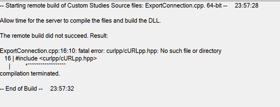

it shows curlpp/cURLpp not found
imageScreenshot 2022-01-12 052924.png / V - Attached On 2022-01-12 05:32:38 UTC - Size: 20.31 KB - 339 views

You can not reference a non-standard library and build remotely. You would need to build your DLL locally to do this. Refer to the information here:
How to Build an Advanced Custom Study from Source Code: Step-By-Step Instructions
