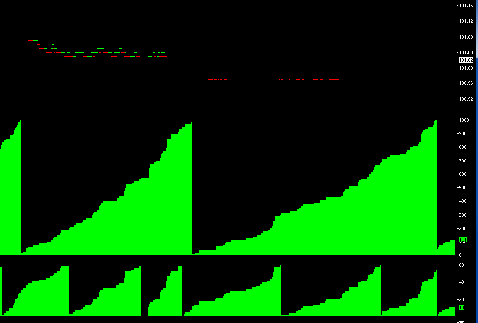

I wanted to see if/how "sc.OnExternalDataImmediateStudyCall = true" effects chart update.
Setting chart update interval to 2000ms, I expected two outcomes:
A. It will plot the chart slow but give true values of studies on every chart update.
B. Or it will really refresh the chart when ever there is new trade.
I had a study that plotted the local pc millisecond timestamp on a 1 tick chart.
In the attached picture, top study is local milliseconds and bottom study is local seconds.
For some odd reason the milliseconds just keep going from 0 to 999 in cycles of +/- 150 seconds [two and a half minutes]
Setting chart update interval to 1000ms gives the same behavior but with 65-70 second cycles.
500ms also look weird...
This means that faster intervals also give wrong timestamps, but since they are fast enough to give more changes we don't know they are wrong.
sc.OnExternalDataImmediateStudyCall really works? doesn't seem like it from the plots.
imageFile1.jpg / V - Attached On 2014-04-08 14:18:28 UTC - Size: 17.37 KB - 617 views

[2014-04-08 17:35:50]
Hendrixon - Posts: 130
Just look on the picture.
On a 1 Tick chart like this, the milliseconds (top study) should be all over that place, very random... but they don't... they just orderly go from 0 to 999.
on a 2000ms chart update interval (like in the picture) it takes two and a half minutes for the milliseconds to go from 0 to 999.
See the bottom study showing seconds... going from 0 to 59 normally... and see how you can almost fit 3 MINUTES in how long it takes the "milliseconds" to do their thing there...
Sorry I can't explain this better cause I can't make any sense why SC behaves like that. its too weird.
For local seconds time stamp use this:
int& IndexFollow = sc.PersistVars->i1;
  if (IndexFollow < sc.Index)
    SYSTEMTIME systime;
    GetLocalTime(&systime);
    IndexFollow = sc.Index;
    Second[IndexFollow] = systime.wSecond;
For milliseconds use this:
    SYSTEMTIME systime;
    Millisecond[IndexFollow] = systime.wMilliseconds;
Remarks:
1.
Don't use sc.CurrentSystemDateTime cause its wrong, it rounds "seconds" instead of truncating so I don't trust it on anything.
For example you report ticks timestamp like this:
00:00:05.450 is rounded to 00:00:05 (five)
00:00:05.550 is rounded to 00:00:06 (yes SIX)
Those are real milliseconds from the feed... not your counter.
2.
use sc.OnExternalDataImmediateStudyCall = true;
3.
you need to make sure your local time is spot on cause even with Meinberg's NTP client you could get +/-150ms from real time based on your system quartz frequency drift.
Date Time Of Last Edit: 2014-04-08 17:37:49

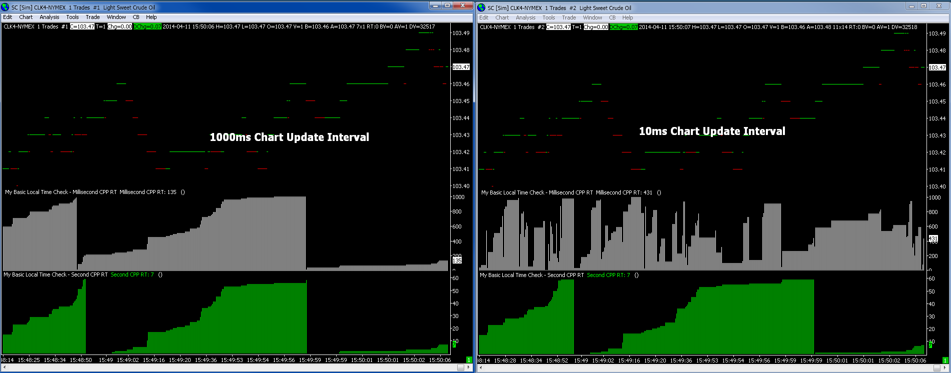

[2014-04-11 13:06:18]
I used the latest 1119 SC version to make the attached picture.
Charts are the same 1 Tick bars of CLK4.
Chart on the left is set to 1000ms chart update interval and chart on the right is set to 10ms update interval.
Bottom green plot is local time "Seconds" part... as can be seen they are not totally identical.
Top white plot is local time "milliseconds" part... and here its totally different plots.
You can see the milliseconds on the left (1000ms) chart keeps building from 0 value to 999, almost in sync with the "seconds".
Also see how this buildup takes almost a full minute to complete.
And this is when sc.OnExternalDataImmediateStudyCall = true which should force SC to calculate studies on every new trade data.
imageFile1.jpg / V - Attached On 2014-04-11 13:03:28 UTC - Size: 82.7 KB - 638 views
