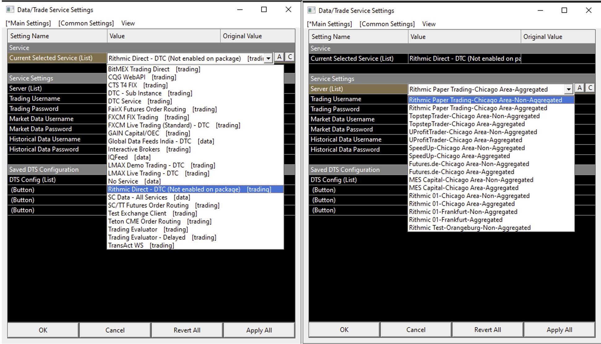

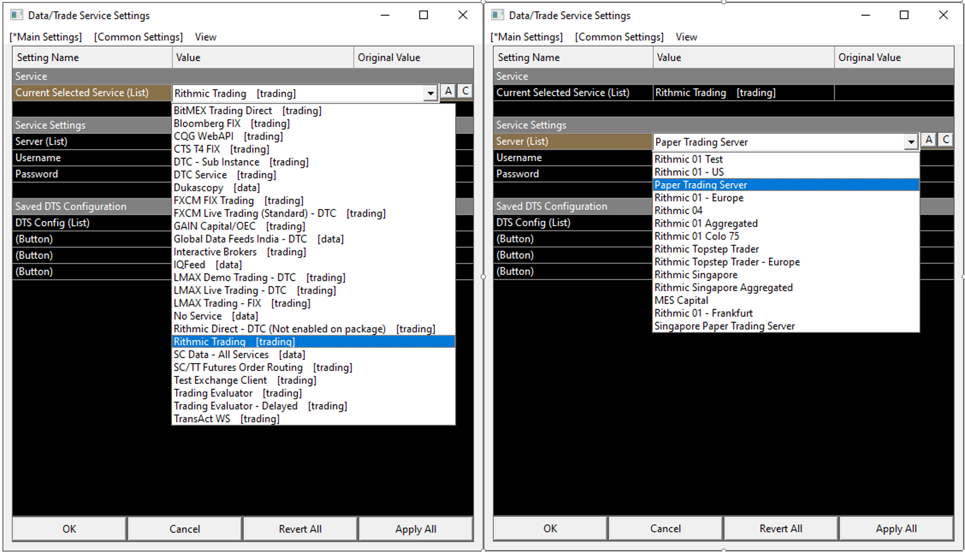

I installed the current version today and was unable to connect after trying all kinds of different settings, after I revert back to the last session installed all was okay again.
Maybe I am missing something? This is an LeeLoo evaluation account with the following settings: see "old SC2281 logon settings" in the attachment.
After I install the current version I am missing several options as in the the 2281 version: I only get: See Current download SC settings in the attachment.

imageOld SC2281 logon settings.PNG / V - Attached On 2022-01-10 13:01:40 UTC - Size: 686.04 KB - 318 views
imageCurrent download SC settings.PNG / V - Attached On 2022-01-10 13:01:46 UTC - Size: 952.92 KB - 360 views

Follow through the instructions here:
Rithmic Trading Platform Service: Setup Instructions
And also read this section on that page:
Rithmic Trading Platform Service: Rithmic Support Policy
You need to change your Service Package to 10 as well:
To change your Sierra Chart Service Package, select "Help >> Account Control Panel" on the Sierra Chart program menu. On the displayed webpage, click on the "Set Service Package for Renewal" link.

Okay, I tried, but was unable to get the current version working.
Then I found out that I actually have service package 3 and this works with SC version 2281, so that could be the issue since for the current version according to the "setup Instructions" info for "Rithmic Trading Platform service" it needs a minimum of service package 10 or higher. (Although this does not make any sense, since service package 10 and higher are all related to the Denali exchange data feed..)
So for now I guess I can't upgrade.
[2022-01-10 17:23:56]
Service Package 3 should not work with Rithmic. If it does, that is an error on our part, and will change, in a few weeks. The minimum Service Package will be 10.
