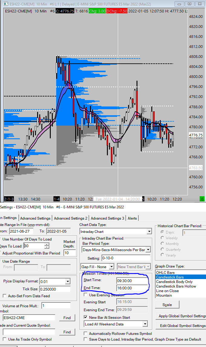

hello
please let me know if possible , im trying to line up the TPO value area lines here from es, on the TPO study its correct, but on my chart on the left the sierra study "tpo value area lines" from the VBP study are incorrect. i have the candlestick chart study just set for day session, which is what i want but the value/POC lines are different. even tho the circled session on the TPO chart is just the day session from the 4th, you can see on the chart, the day session on the 4th is off. How can i make them match correctly without having to have my candlestick chart with the VBP study set to 24 hours? hopefully this made sense??
imageCapture7.PNG / V - Attached On 2022-01-05 17:17:35 UTC - Size: 212.28 KB - 270 views
[2022-01-05 17:19:22]
HeyUgly - Posts: 290
session time for wrong value lines here, i just want the RTH session this chart
imageCapture7.PNG / V - Attached On 2022-01-05 17:18:53 UTC - Size: 86.5 KB - 265 views
[2022-01-05 17:21:12]
session time for the TPO chart which is correct, i just dont want the evening session on my candlestick chart
imageCapture7.PNG / V - Attached On 2022-01-05 17:20:40 UTC - Size: 147 KB - 262 views

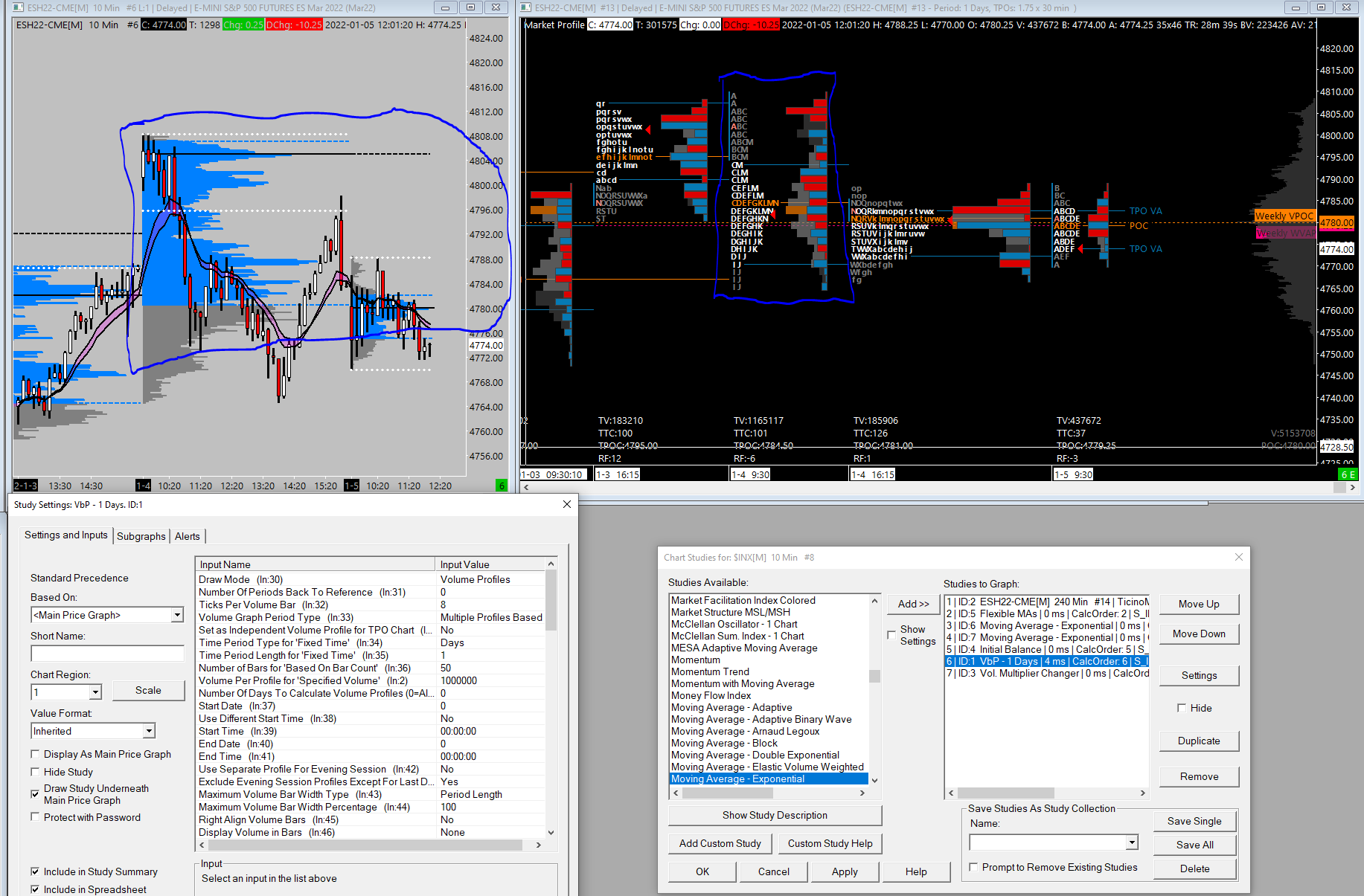

[2022-01-05 18:39:12]
yes i have the setup that way on the TPO chart, those levels are fine. on the candlestick chart, using the VBP study i only want the RTH session VAH VAL POC on that chart, not the evening session graphed.. thats the chart thats messed up. the TPO chart is fine.

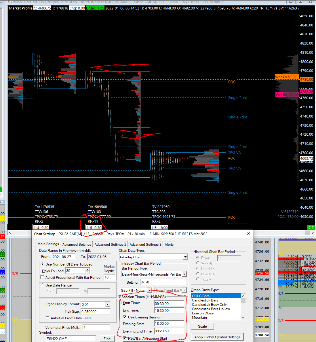

[2022-01-06 11:27:57]
sure, is is the TPO chart, with session time setup. these seem correct
imageCapture7.PNG / V - Attached On 2022-01-06 11:27:50 UTC - Size: 118.7 KB - 258 views
[2022-01-06 11:29:40]
now here, using the VBP study , with the SAME sessioion time as the TPO chart, my Value areas and POC are different. is what im trying to fix. why are they different? the session times are the same? what am i doing wrong here? ideally id like to NOT have the evening session on the candlestick chart, just the RTH session, but i need to make sure the value areas are correct here.
imageCapture1.PNG / V - Attached On 2022-01-06 11:28:55 UTC - Size: 83.23 KB - 253 views
[2022-01-06 15:36:59]
Are you comparing the Value Area of the TPO to that of a VbP? These are calculated different from one another (by default), so you can not expect them to be the same.
Although, if you have the Inputs for Value Area Highlight Based on Volume and [/b]Point of Control Highlight Based on Volume[/b] set to Yes, then these should be the same for the same time period.
Let us know if you have these Inputs set to allow the comparison between the TPO and VbP Value Areas.
[2022-01-06 15:41:13]
yes i am comparing the 2, was hoping for them to be the same with same session time set for both charts, as i want the volume profile on there with the VAH VAL POC. its close, just off. I'll continue to mess with it, Thank you John appreciate the quick response

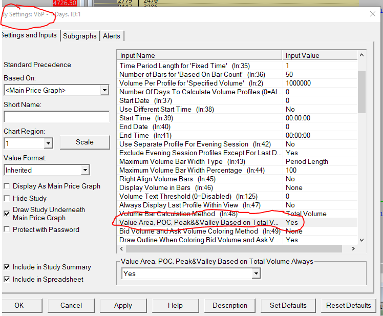

[2022-01-06 15:43:19]
made sure yesterday those settings were turned on pic referenced for the VPB study
imageCapture7.PNG / V - Attached On 2022-01-06 15:43:15 UTC - Size: 58.44 KB - 264 views
[2022-01-06 16:10:28]
that last suggestion was gold thank you the TPO didnt have those settings set yo yes, case closed
