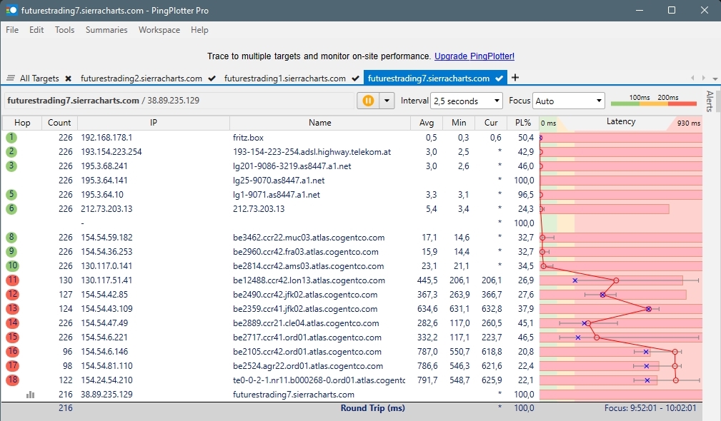

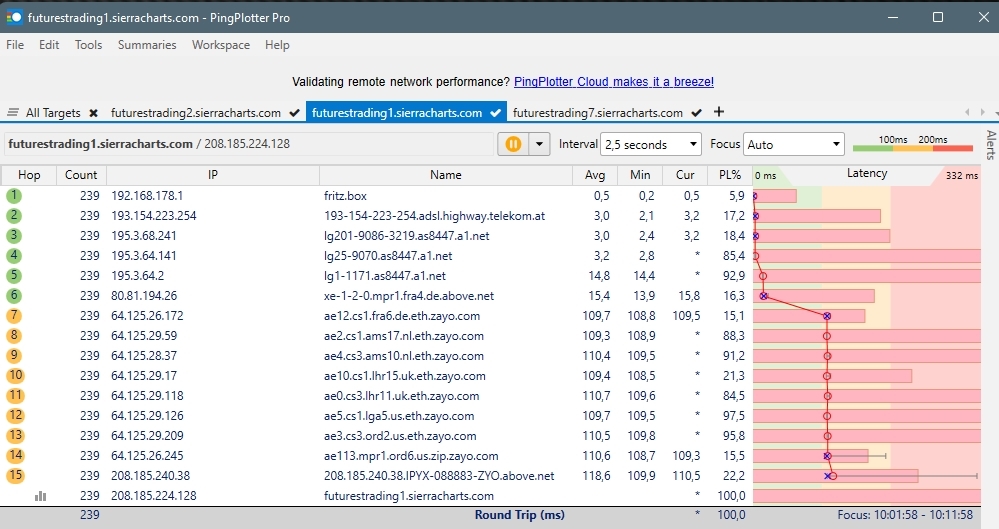

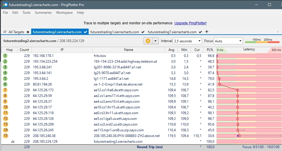

I checked these 3 IPs with PingPlotter Pro and the route doesn't look good (see screenshots attached).
I am in Austria and have A1.net FTTH connection, what kind of peering information should i give my IPS to make the route to Chicago work better?
Should I find another IPS that can peer with Hurricane Electric?
Thanks for the help!

[2022-06-29 11:14:14]
The primary connection and the connection which will be used almost all of the time is futurestrading2.
It also looks like the connection is quite direct from what we see in that screenshot. It goes from your ISP over to Zayo which is the ISP that it is used.
We cannot provide any further help.
