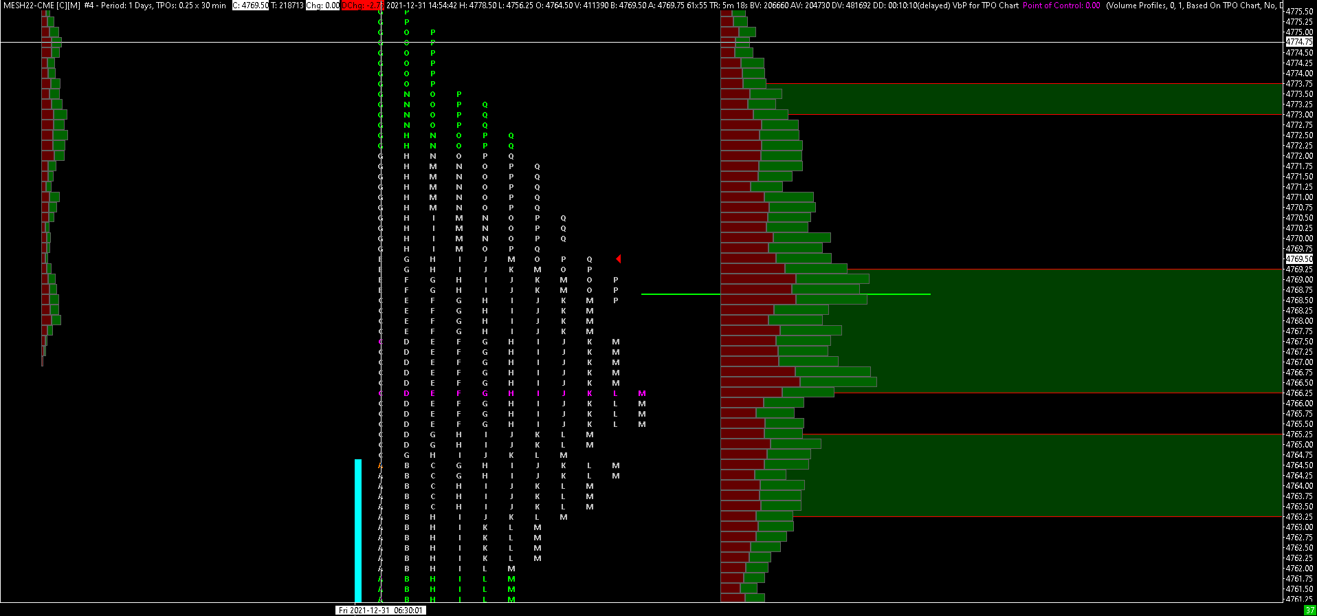

| [2021-12-31 20:06:07] |
| Ken Smith - Posts: 58 |
https://www.sierrachart.com/image.php?Image=1640981095358.png here is my chart after I hit begin and end thanks ken |
| [2021-12-31 20:36:59] |
| John - SC Support - Posts: 48377 |
It looks like you are not using the start and end options correctly. You need to right-click on a profile and select "Merge Profile Begin", and then you move to another profile (the one that is 30 days away) and then right-click on that profile and select "Merge Profile End". The system will then merge all the profiles together including the ones that you selected as the Begin and End profiles.
| [2021-12-31 20:50:38] |
thanks very much, that did it, what I would like though is if all 30 days could just be in a neat single profile ( it would be long top to bottom ) just like the red and green profile |
