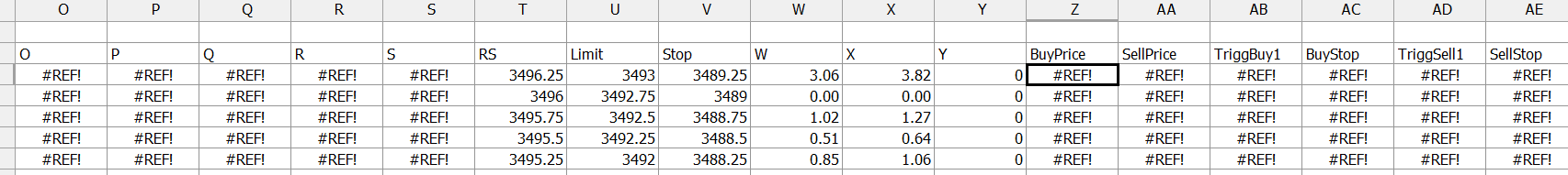

My spreadsheet stopped working with ATCharts version 1116. I get #REF!

I have installed version 1117 but it did not help. almost every code get the same error #REF! They all worked in the past. Regards Outlander

=AND((U3-D3)>=(3*AI3),AZ4>AZ5,AJ3<100)
=AND((C3-U3)>=(3*AI3),AZ4<AZ5,AJ3<100)
=AND(AC3>0,AJ3<100)
=AND(AE3>0,AJ3<100)
=AJ3=100
Regards Outlander

This is what we found in regards to this:
All of the formulas the user posted are fine and do not give any errors in the current version. The #REF! errors must be coming from one of the referenced cells that is not visible, such as AJ3. Or there may be some circular reference among the given formulas, but I cannot tell without knowing where those formulas were located. I may need a copy of the whole spreadsheet to see where the error is coming from.
One thing we can let you know is circular references are not supported at all.
Can you provide us a simplified example spreadsheet to demonstrate this #REF! error?

Hi, I still have some problems with the Non-CLR spreadsheet. I have used TechTraders code in the past without any problems. But now I get this error code: #REF!
It would be nice if you can fix it. Regards Outlander
(ZigZag is in column AA)
Column X =IF(AND(AA3<>AA4,AA3>0),SIGN(AA3-AA4),X4)
Next, determine the last high point.
Column Y =IF(AND(X4>0,X3<0),AA4,Y4)
Finally, determine the last low point.
Column Z =IF(AND(X4<0,X3>0),AA4,Z4)
Columns Y and Z will plot horizontal lines of the last high/low until a new high/low is determined by your zigzag criteria.
